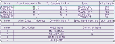

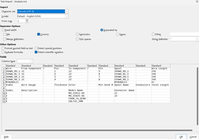

If you have made the schematic connections to (Creo) drawings then you can get the csv out of the drawing table (for final checks before release)...
Select the table and select "Save Table->Save As CSV"
You will get the CSV of the items that you have on your table...
This is the table in cable drawing...
This is the imported csv from above drawing...
