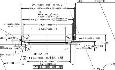

Converting metric part/drawing to inch
When I convert a metric part to inch I get 12 decimal places on the drawing. how to I limit the decimal places to 4?

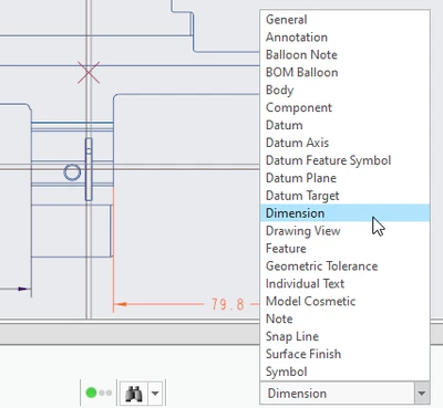

(I'm using Creo 7, I hope these are the same in Creo 5)
In the bottom right corner you can choose just to select Dimension:

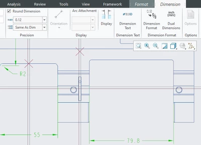

Select everything in the drawing, and then at the top you will have the Round Dimension option:

Once you have the drawing converted to metric, select all of the dimensions. One of the tabs will be Precision and it will have a drop down for you to select the number of decimal places to show on a drawing.
On metric drawings, decimal places are not used to specify the default tolerance for a dimension like an inch drawing.
You should also look at setting the lead_trail_zeros detail option.

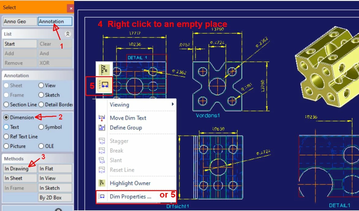

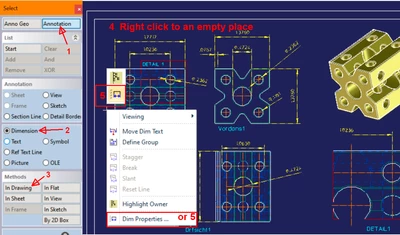

Push F2 for selection then (look better attached file 😳)
and change what you want.
Success
