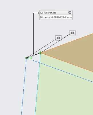

i am having a hard time trying to model a part based off the measurement report that we have gotten and i am wondering what i am doing wrong or how to more accurately model the part.
when i try to use a sweep function, i find that one or more corners (depending on if it has 3 or 4 faces) tend to be slightly off. is there a different function i can use to force creo to make a body that fits within the coordinate boundaries? the surfaces should be flat .

I think that coordinates included in Excel file are wrong.
See ITEM1 (for example)
S5-S8 points have Z=0 ... this means they lie in a plane (let's call her PLANE 1)
S5 -3,6244 16,3355 0
S6 8,5455 45,5814 0
S7 58,309 0 0
S8 0 0 0
S1-S4 points do not have the same Z value ... this means they do no lay in a plane parallel with PLANE 1
S1 -3,6151 16,3385 -50,0018
S2 8,5564 45,5903 -50,0067
S3 58,322 0,007 -50,017
S4 0,0088 0,007 -50,0018
Also:
S1-4(X) <> S5-8(X)
S1-4(Y) <> S5-8(Y)
This probably means that points does not belong to planar faces.

I agree with @MartinHanak that the points in your spreadsheet do not create planer surfaces.  This may be due to rounding errors in creating the point values.  If I create a datum plane from 3 points on a side, the 4th point is not on that plane except for the surfaces with all Z locations 0.
kdirth
To create the shapes that match all of the points you need to create curves between the points and use boundary blends to create the sides.
