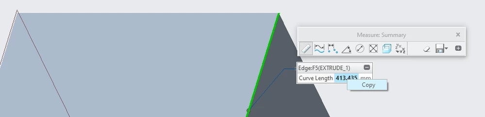

Hi all,
I am working in Creo 9.0.1.0 and when I measure a feature part, then copy the measurement, it seems that Creo does not copy the value.
I have tried Ctrl + C to no avail, and right click, copy to no avail. I have tried copying other things on my computer and there's no problem with it. Ctrl + C clearly works in Creo as I can copy and paste a datum plane with it, for example.
Any idea why I am unable to copy a measurement? It is breaking my workflow as I need to manually write down the number then retype it where I want to use it.

Not sure, maybe it's a bug with Creo 8 - I can't tell as I'm still on Creo 4.
But what happens if you try to paste the text you "copied" form Creo into another application, for example, notepad?
I find sometimes Creo copies extra characters (e.g. TAB) and then Creo refuses to paste such text into its input fields (i.e., it pastes "blank values)

Thank you for your response. When I paste in Notepad, nothing happens!

in Creo 9.0.0.0 I select value, press RMB, select Copy and the value is inside Clipboard.

Interesting. Perhaps it is a bug with 9.0.1.0? I tried this, and it also does not work.

I just tried with 9.0.1.0. No issue.

But, I found this article CS376590 which might help you.
This issue was already reported to PTC and it has been fixed in Creo Parametric 9.0.3.0. This issue is specific to a few machines or users and not possible to reproduce for everyone.

I noticed it in a recent Win 11 update, and yes, my Creo 9.0.4.0 doesn't have this issue. I know 2.0 is far out of support, but I'm trapped in a colleague-version-lag bubble.
