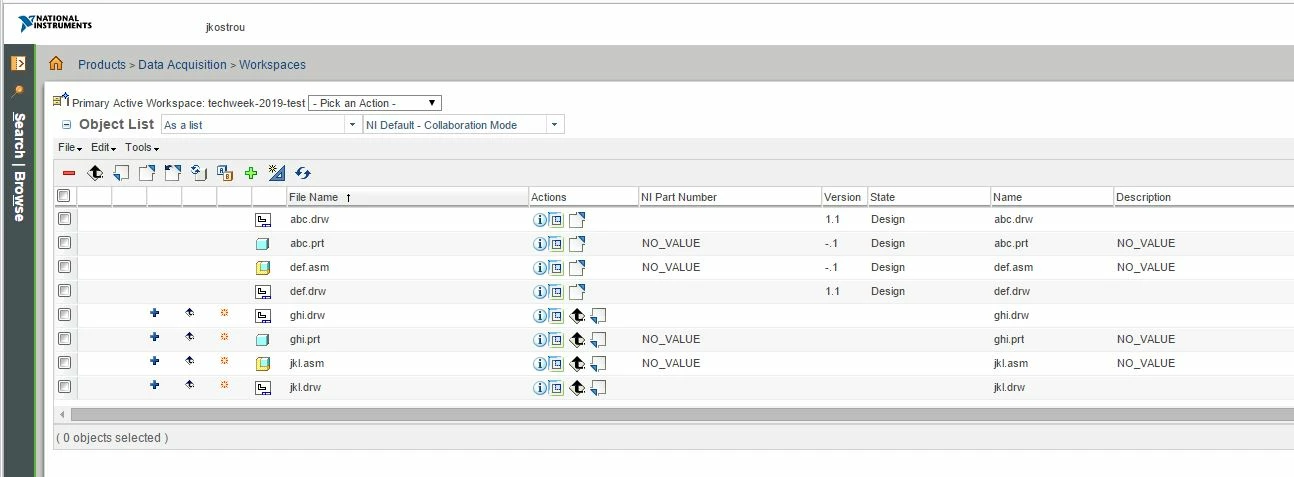

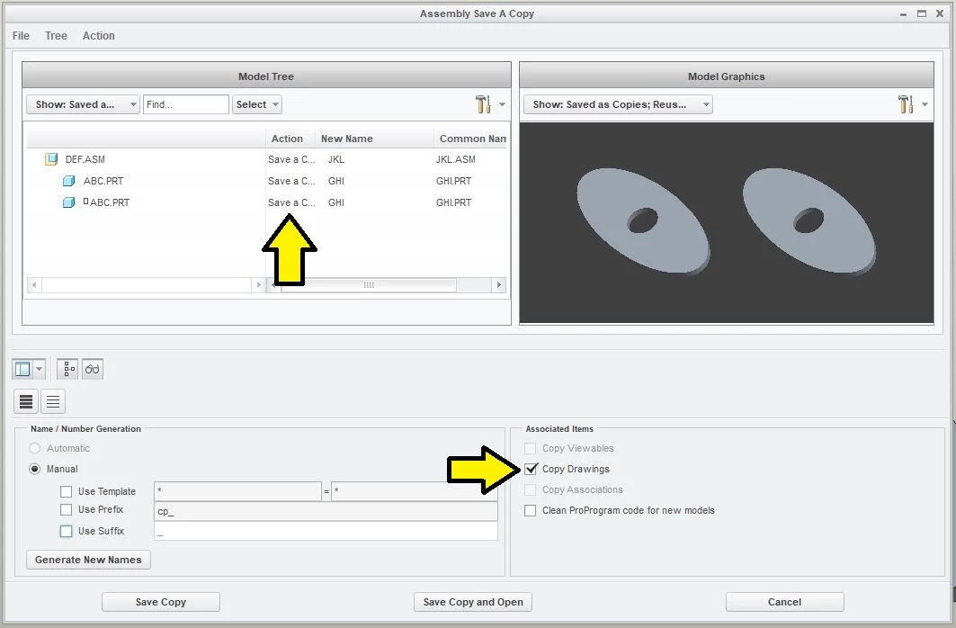

This was key for my success: Having the part (or assembly) name exactly match the drawing name, this shows your intent to creo in the most direct way.
This is using the file, save-as method within creo (not windchill)
Create parts and assembly, then create drawings that exactly match the drawing name to corresponding prt/asm
ABC.prt ----> ABC.drw
DEF.asm --->DEF.drw
underlying creo config: config.pro, setting: rename_drawings_with_object set to "both"
With the asm model open (DEF.asm in this case), do: File>Save As>Save a copy
rename the asm model and the child part (ABC.prt in this case)
Make sure Associated items > Copy Drawings box is checked
operation results in 4 new items, 1 part, 1 assembly, and 2 drawings
GHI.prt + GHI.drw
JKL.asm + JKL.drw
