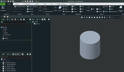

Thank you Catalina for your quick reply. Let me clarify it by using screenshots. Let's say I have a part:

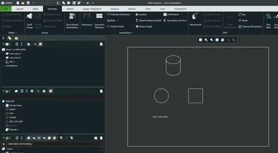

And I have a drawing of it:

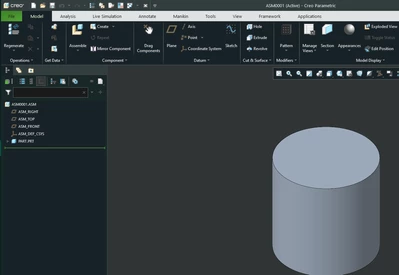

I need to create an assembly file by using that file:
But also I would like to copy the drawing of the part to the drawing of assembly. With its notes and its views. Since the part is in that assembly I can use drawing of the part in the drawing of the assembly.

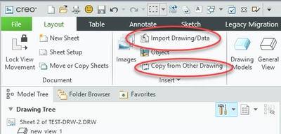

You can import a drawing from another drawing, maybe this will help you! It will copy all the sheets, views, models from one drawing to another
There is also, Copy from other drawing. It allows you to select exactly what you want to copy from one drawing to another.
Overlay is also another command, but it still uses both drawings but one is "shown" on the other drawing, its less commonly used.
