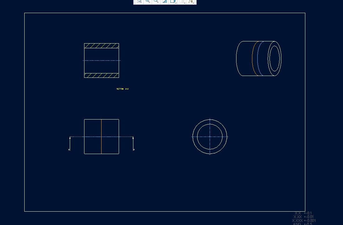

I created couple of cosmetic sketches to show paint masking area on my solid part.
In my drawing of that part, I can see those sketches only on my ISO view, but not on front or any other projected views.
Any idea how to make cosmetic sketches visible? How to control it?

So brown line is a sketch and blue is a cosmetic sketch. Both are seen on ISO view and only sketch and not a cosmetics on a projection view.
First Q : is it possible to control cosmetics in my case to be seen or not.
Second Q. The reason I used cosmetics is that when I used regular sketch it was not sectioned on my x-section top view (at work and I am showing home version) and sketch was seen on x section view. What controls that? I tried different settings for the view and did not get needed result (sketch not seen).

Hello! from your descriptions, you seem to say that your work and home setup produce different results - namely that at home, your sketch is not shown in the section view (screenshot) while at work it is shown.  So I investigated some things in my setup (Creo 3.0 M130)
So for your second Q, this drawing option seems promising:
remove_cosms_from_xsecs
(in drawing mode, file->prepare->drawing properties->detail options (change)->find->(search descriptions)->type keyword "cosm"->find now)
If set to "trim", then system removes from display the portion of datum curves and cosmetic features that is in front of section cutting plane.
If set to "total" (default), then only things entirely in front of the cutting plane will be removed from view...
Now the long winded answer to your first Q:
So cosmetic sketches are a bit of an oddball and perhaps it is wise to avoid them.  They are very handy when you are dealing with non-parametric things such as logos and labels that contain a lot of entities because you can use the "under-constrained" mode and essentially doodle something without the system crawling to a stop trying to solve all the sketcher constraints!
And another thing I learned during this investigation, is that cosmetic sketches they are drawn on a plane that is orthogonal to the view plane will not be shown in that view.  This answers why your cosmetic sketches are not showing up on any orthogonal projection views.
You can tilt the sketch plane about 0.1degrees and get a decent looking result.  But why use such a hack when a regular sketch can suffice?
One more thing about cosmetic sketches - you can right-click on a view and "erase/show cosmetics".  So that's one way to control the visibility of cosmetic sketches and so that can be an answer to your first Q.  Unfortunately, that is not a great solution if you have threaded holes and you do want the cosmetic threads to stay shown in the view!
So the "proper" method already mentioned in this thread is to put your sketches or cosmetic sketches on layers that can be blanked or shown on a per-view basis.
Layers are not easily explained, so if you don't know what I'm saying, you need to invest some time learning by reading these forums (just search for "layer" and go through the found discussions) and other online help (just google "creo layers")
June 20, 2017
So it looks like that a regular sketch will do the trick when curves put on a layer.
Can anybody tell me how to turn layers on and off in a particular drawing view? Somehow I was able to do it with 2 curves our of 4, but can not trace it back.
What layer will do it? Assy layers, Part layers, Drawing layers? I created my curves in ASSY.
June 20, 2017
Open the layer tree in the drawing mode.  At the top, there is a selection box next to the arrow that allows you to manipulate the layer state for the drawing, model and any view.  Simply select a particular view to "set" the layer state for that view to be independent from the drawing.  In this independent drawing view layer state, blank the layer which contains the curves you want to hide.
You can click on the arrow next to the pull-down menu and by the color of the view outlines you will be able to tell what views have layer states that are driven by the drawing layer state and what ones are independent.
Further info in this forum by searching for "drawing layers".  E.g., How can I set the layer status for all drawing views
