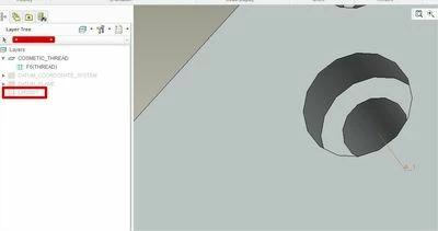

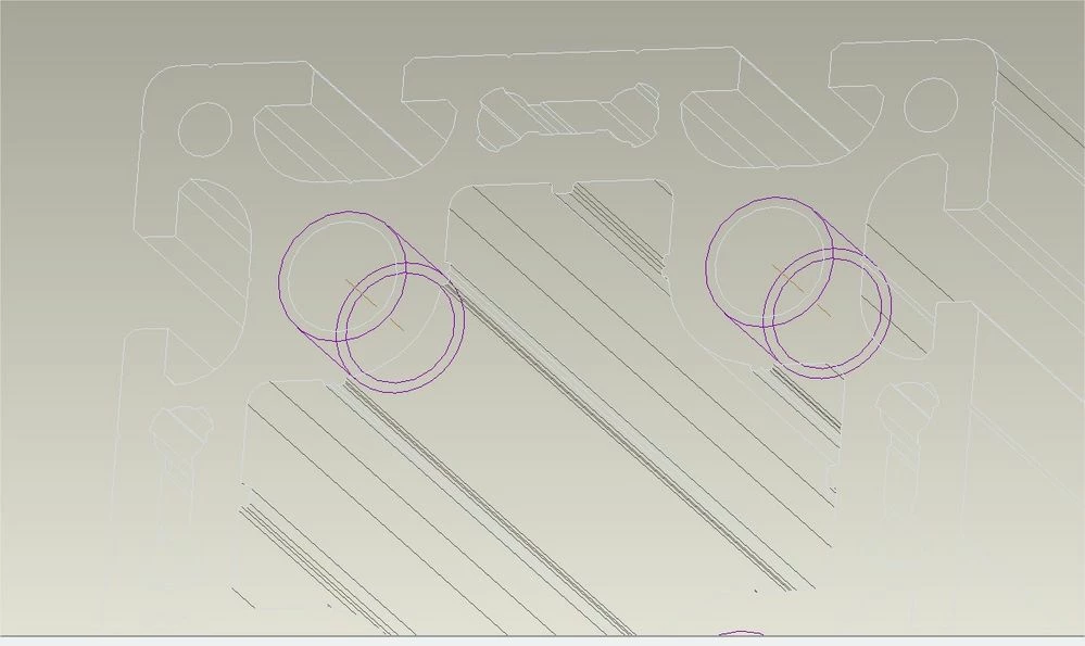

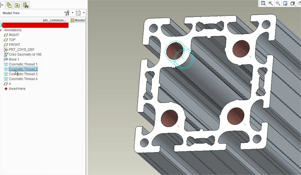

We are using some models imported from Creo Elements Modeling (OSD), then we create cosmetic thread features The rule is to hide all axis in the 3d (in the layers) but if I hide the axis from the cosmetic thread, the thread is also hidden
Is there a solution ?
PrtScr capture_37.jpgthanks

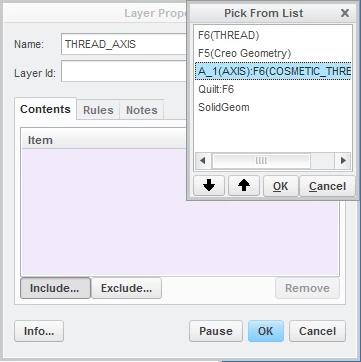

see THREAD_AXIS layer in uploaded part.
I created new THREAD_AXIS layer. Then I placed mouse cursor on thread axis, clicked right mouse button and selected Pick From List command. Now I was able to select thread axis from menu. See following picture.

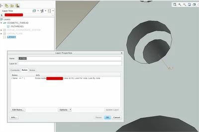

hello Stephen
I can't dissociate the axis from the cosmetic thread feature
if I select the axis in a layer ( with a rule) the axis is not hidden
I can hide this axis only if I hide the cosmetric thread layer
lay0001 hidden not the axislay0001 hidden not the axisdefinition of the layerdefinition of the layer
