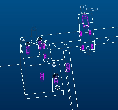

Cosmetic threads? Hiding threads in hidden line removed view

In the model below, I have the hidden lines turned off yet you can see the threads. Are these cosmetic threads and if so (or not), how do you turn them off off when just printing the model (not a drawing)?

In the view display properties there is a setting for hiding quilts, which is what Cosmetic threads are.
This setting is not available in section views - there is a setting when creating the section to hide quilts when the section is made.

I am in WF5/Creo if that makes a difference. I do not see a setting for hiding quilts in View tab.

i would think creating a layer & adding the threads to it would be the best way to manage this. That way you can have them visible on your drawing but turned off in your part. Remember to change your drawing layer status to "ignore display status of model".

Acutally, I just was to do it temporarily for a quick print of the model for discussion. It confusses some when they don't understand what all the extra lines are.

Just right clicking on the hole feature in the model tree will reveal "hide", the hole remains the cosmetic threads disappears.
January 17, 2014
you have to set the config option fasthlr to yes in order to hide cosmetic threads.
