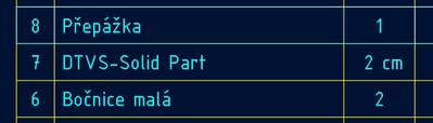

I have to display a BOM table on the drawing.
Default the table will display POS number and Quantity of the item e.g.: POS 20  Qty 2     (each)
In this case I have added a tape to the ASSY, which is also displayed in the model and it will be
added in the assembling stage from roll.
Is it possible to change the BOM table to e.g.: POS 20 Qty 2 cm ?
I can create a bulk item, but that is not visible in the model and the drawing.
An other way is to create a part which displays 2 cm tape, but in that case I have created a separate item, which more or less produced before the assembling action.
Any idea how to implement this?

Jun 26, 2024 7:47 AM UTC
I guess you can give "length" parameter to the tape part and then just check if it exists in table. Not a perfect solution as you will probably need family table to cover the part sizes.
if exists("asm_mbr_length")
	quantity=asm_mbr_length
else
	quantity=rpt_qty
endif
 Or you can put in both part and bulk item and filter part from table everytime and keep the bulk item.
Jul 4, 2024 2:44 PM UTC
Hello Radovan,
Many thanks for sending this proposal, but I have still a couple of questions.
What I understand is that I have to add an attribute to the part e.g. "length".
On the drawing of the assembly I am using a BOM table, which I have configurated as follows:
I have added the relation you have mentioned above to that table, but that fails.
I have also tried to add this relation to the relation table of the assy, but that also didn't do the trick.
Can you explain how to implement this?
Thanks.
Jul 4, 2024 8:31 PM UTC
I am out of the office but I think you need to change rpt.qty to rpt.rel.quantity so it takes value from relation.
