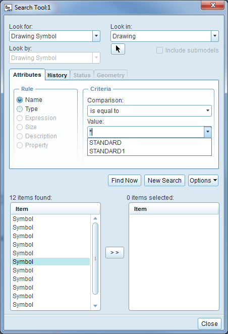

You can use the search tool. Simply search for "Drawing Symbol". You can either find all of them or one specific type.

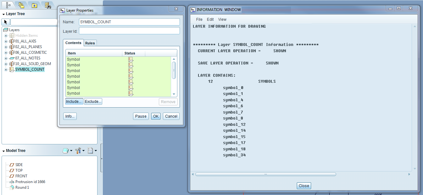

You can also add all symbols, or that specific type of symbol to a layer using rules. If you view the info for that layer it will tell you how many of them are on the layer.
