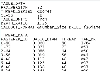

Pro/E allows us to to create Countersunk and Counterbore holes in the model. Is there a way to get the note on the drawing to read in the format shown in the attched image?
13 replies
March 5, 2013
I tried to do this in the past. (I'm on WF3) I know you can edit the
'format' of the note in the .hol file. Below you can see what this
looks like in notepad...
You want to edit the CALLOUT_FORMAT line. If I remember correctly you
will need to create different .hol files for each different callout you
want though. (i.e. one for CBore and one for CSink) This is due to
wanting some things on one call out and others on another callout. I
was hoping they would have this fixed with Creo. Can anyone chime in on
that?

The hole table functionality is definitely lacking. There is the ability with the hole table to create a matrix of callouts for each possible configuration of the hole tool. Look in the documentation for "DEFAULT_CALLOUT_FORMAT_DATA". The major limitation with the hole feature in general is that the note callout text (as defined in the matrix or the "CALLOUT_FORMAT" field) will NOT update the note text format during feature redefinition unless you manually pick "update note". This means if you decide to "turn on" some aspect of the hole feature, the callout will not reflect your change unless you remember to manually tell it to reset the note text every time. Below is a sample of this matrix (still a work in progress). This will look best when viewed in a constant width font.
Tom U.

There are some improvements that the hole feature could use, but you do not need separate files to change the note callouts. See attached on formatting the callout matrix.
Bill

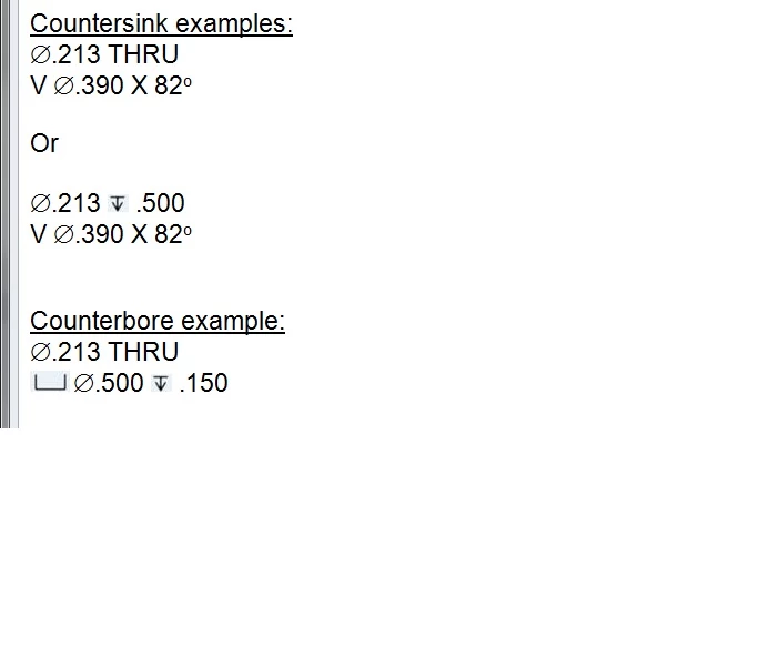

Good Friday morning to all,
From Tom’s email show below showing the Default_Callout_Format_Data. Does anybody know if it’s possible when you have a clearance drill to differentiate between the Close Fit and Free Fit that Creo 2.0 now offers in this table? I can either call out the Free Fit or the Close Fit, but format of the note won’t change when switching between the two fits. I have attached my unc.hol to show you what I just created for my company.

You can reference any of the hole table columns directly in your note, including “CLEAR_DR_CLEAR”, “CLEAR_DR_FREE”, etc. You cannot, however, automatically change the format of the note based on which fit is used since “fit” is not one of the columns in the hole callout matrix. Changing the fit will not select a different row in the matrix.
Tom U.
March 8, 2013
I should clarify one thing. If you want the note to read correctly regardless of which fit is used, use “DRILL_DIAMETER” instead. This will always read the actual value used instead of simply what is listed in the table for the three different fits.
March 8, 2013
Tom,
Thanks. That worked perfectly.
Mike

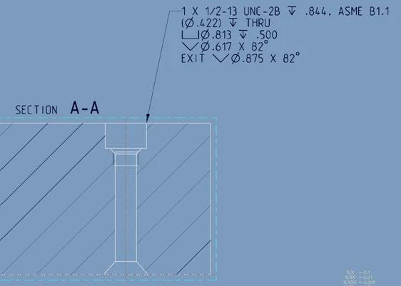

March 8, 2013
TABLE_DATA
PRO_VERSION 24
THREAD_SERIES HELICAL
CLASS 2B
TABLE_UNITS inch
DEPTH_RATIO 1.25
CALLOUT_FORMAT <ctrl-a>w<ctrl-b> <ctrl-a>n<ctrl-b>&CSINKDIAM # .015
&CSINKANGLE[.0] $ # 5 $ / &METRIC_SIZE UNC-&THREAD_CLASS / &THREAD_SERIES
COIL INSERT / THD PER NASM33537 / FULL THD <ctrl-a>x<ctrl-b> MIN/ TAP
DRILL <ctrl-a>x<ctrl-b> # .010/ INSTALL INSERT .75-1.5 / TURNS BELOW
SURFACE
These take alot of work to get setup but hey can work the above Callout
format gives me this when I show the note on a drawing.

March 8, 2013
Brian,
It is a lot of work, but like you said once you get it set up it’s absolutely fantastic. Now I get this automatically created when I put in a hole feature.
