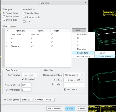

Apr 30, 2025 5:41 PM UTC
Hi @BT_12786803
You may try adding hole feature parameters in table using Hole Table > Add > Parameters > Select > Select Feature and add required parameters.
I hope this will help.
Thanks.

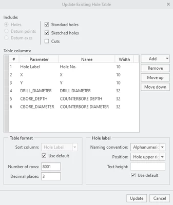

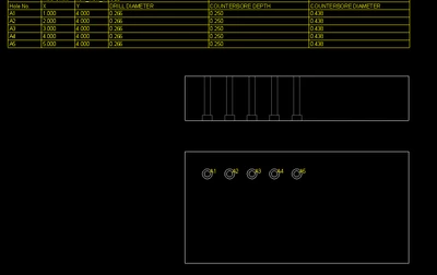

mkajdan
Apr 30, 2025 6:21 PM UTC
Use the parameters for the hole features in custom hole table columns.
Apr 30, 2025 7:41 PM UTC

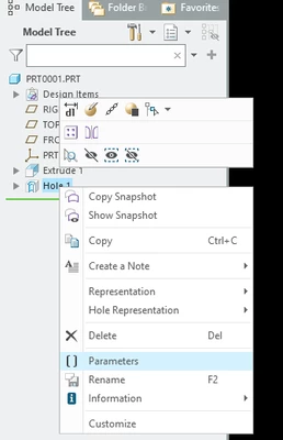

Thank you. How are you able to insert the CBORE_DEPTH & CBORE_DIAMETER? Where are you accessing the table in the first picture you shared?
mkajdan
mkajdan14-AlexandriteAnswer
Apr 30, 2025 7:58 PM UTC
To insert the counter bore depth and diameter, add a new row, Parameters then enter the parameter name.  You can access the feature parameters by right clicking on the feature in the model tree then selecting Parameters.
