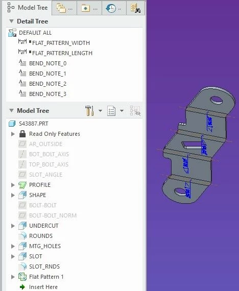

I would like to know if it's possible to count the amount of bends in a sheetmetal profile.
What feature does a bend belong to, other than an edge? Because not every edge is a bend.
Thank you.

When you create a flat pattern, a note is made for each bend.

You can explore Bend order or search tool. Search tool will give you the numbers for features of Sheetmetal type design. But not with further details as reference edge details and all..
