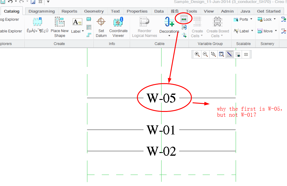

In Schematics,I create a design use the sample directory。I creat a Cables about 3 conductors。When I palce the first conductor,it's label always Shown as a W-05 but not W-05,why?

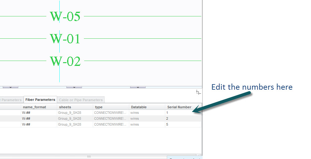

look like simple bug, you can contact technical support .
as workaround, after placing all conductors - just edit the serial number in the embedded parameters panel.
