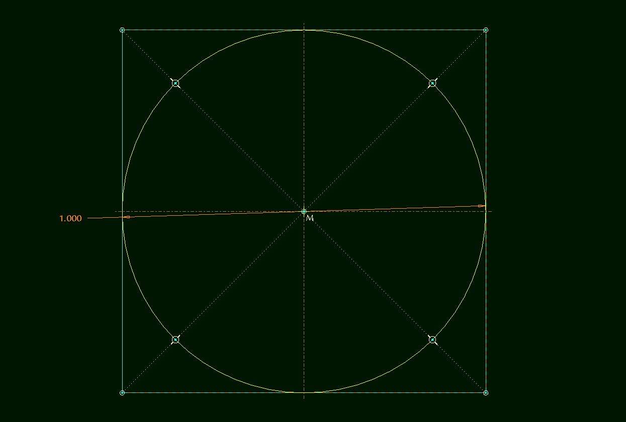

1) Equal number of segments is all sketches. (or use blend vertices)
2) Start points need to be in the same relative location for both sections other wise you end up with something like:round-to-square-twist.jpg
In the sketch for the circle, I broke the circle in locations relative to the corners of the square using the break tool as you see below
Does this help?

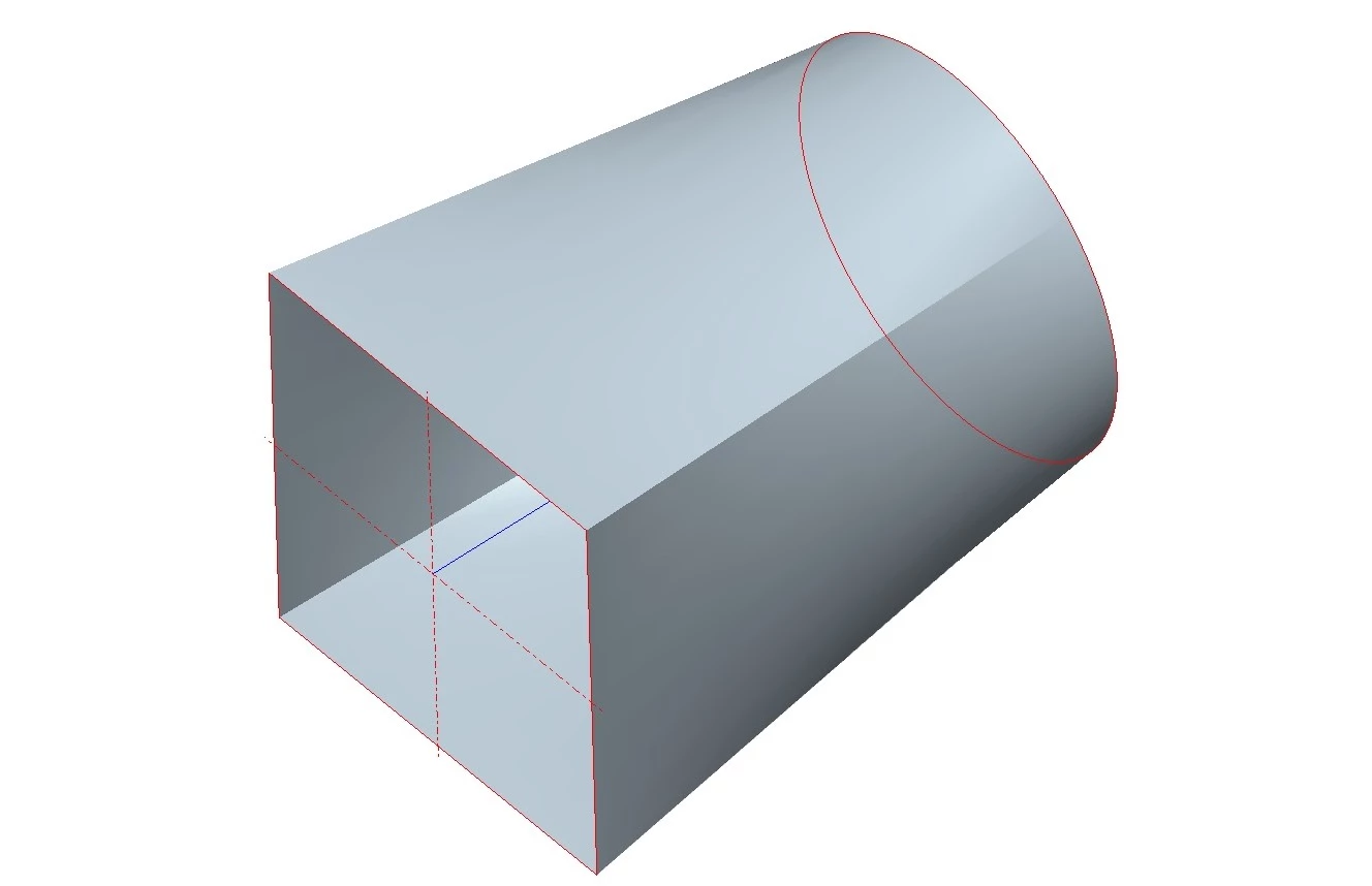

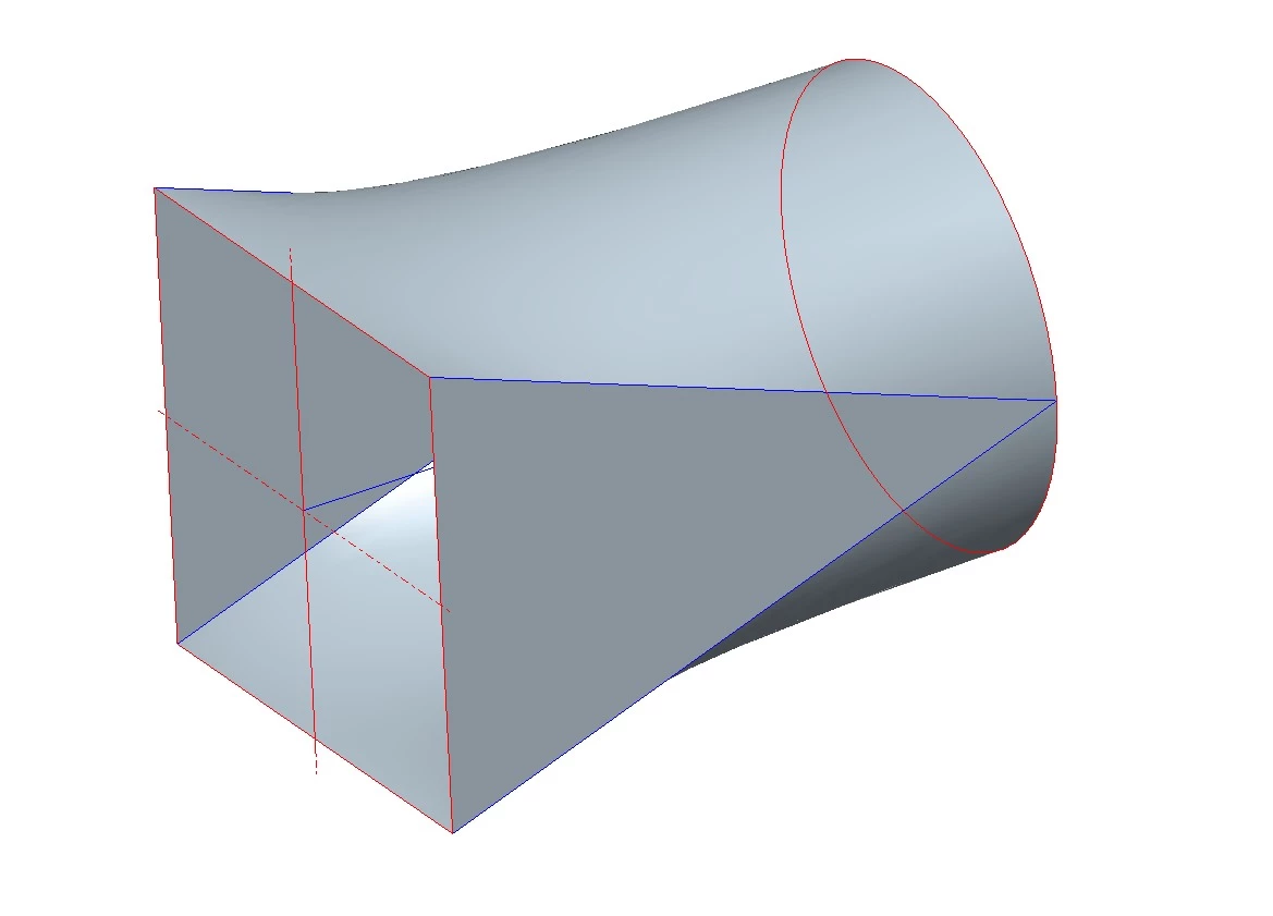

Colette,
Attached are two quick shades of round to square transitions. Is this what you are referring to?
-Greg

Colette,
I made the one you see in square-to-round as a swpet blend. Is that result acceptable?
If so, I will give you some pointers on that geometry. Otherwise, I can try to explain square-to-round2.
