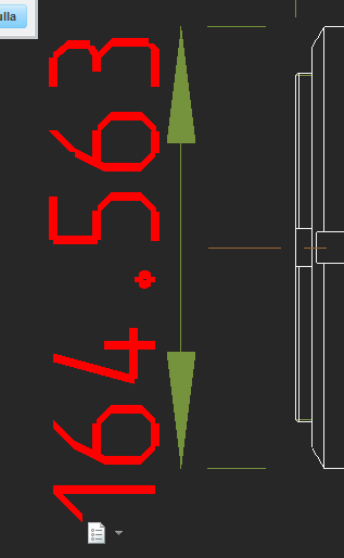

Hi to all,
when i try to create a dimensions in Creo3 (ex. space between two lines) i have to:
1) Click on first line
2) Control+Click on second line
3) Middle botton click
4) Middle botton click if i don't want double value.
Can i avoid 4) step with a config.pro option?
Thank you.
Picture after 3) step.
