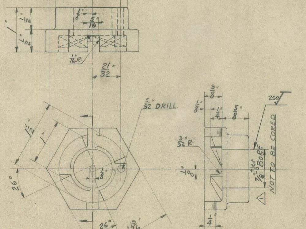

I am working on redrawing a part from an old 2D print.
I am stuck on creating the 4 internal teeth on the main ID.
I do not know how to get a 3D curve on the surface and then i can merge surfaces and solidify to make the features.
TIA

kdirthAnswer
Jun 9, 2023 12:42 PM UTC
Here is a quick start.  I used the trajpar parameter to create the ramps.

Jun 7, 2023 8:44 PM UTC
Here is a simple part I created a while back with a similar feature.  Might give you some ideas.
