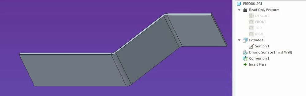

Extrude the line using thicken sketch, then convert it to sheetmetal and add bends to the corners using conversion.

You can also start in sheetmetal and skip the conversion by using Extrude.  The line sketch is thickened and bends are added, both values can be set in the tool.

Very nice. Thanks. It works perfectly.
