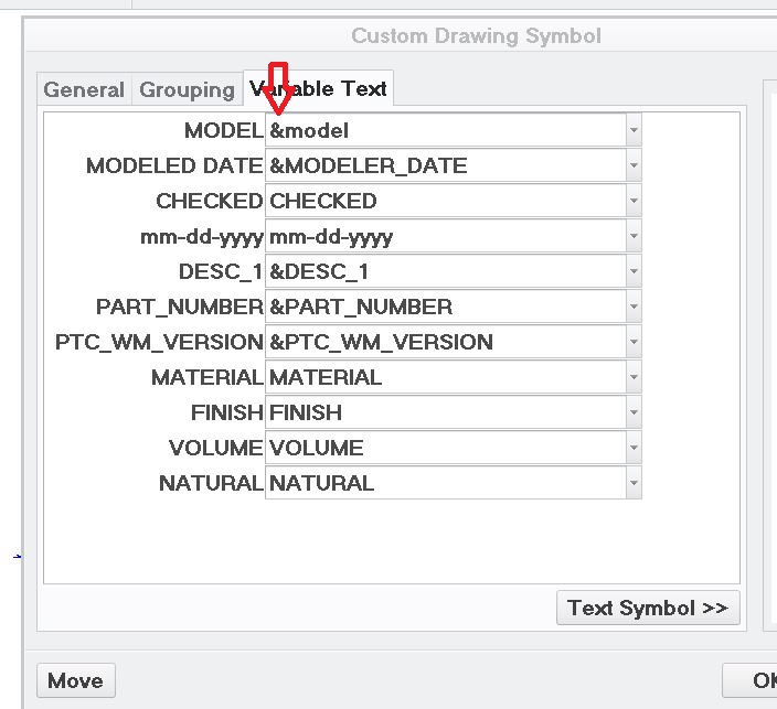

I have a drawing format that I am creating. I have it all set to go but when I add it to a drawing, the only way to get the text to fill in is to add "&" to the text in the pulldown. How do I get the "&" to be included in the symbol so I don't have to add it all the time? Thanks.

1.) Use tables for dynamic information (like parameters read from the model.) They are designed for this and will automatically populate when different formats are applied to the same drawing or a new drawing is created from a template.
2.) Use symbols for static information that will never change. Borders, zones, logos, etc.
3.) Use the built in drawing system parameter &model_name in a table to display the name of the model. (There is no need to create this in the model relations.) Also, this parameter will never point to the drawing, even if no model is present.
4.) To reference parameters from the model, but not have the drawing replace them with "dead text" if they're missing or use the drawing's value instead, create single cell repeat regions that only display that one value. Set the repeat region parameter to &mdl.param.value and the repeat region filter to &mdl.param.name == <PARAMETER_NAME>. Since there will only be one parameter in that one model with that name, the repeat region will never grow. This is a very robust way to reference model parameters.

My forms all have a space " " after the &parameter and then when I bring in the form I have to edit each and delete the space and the value fills in.
April 22, 2015
My thinking is the problem is that you are defining a variable (parameter) as a variable. I would try entering the parameter as static text rather than as variable text.
April 22, 2015
After first response I noticed that it looks like you are creating a Symbol to act as your Drawing Title Block... For Title Blocks I suggest creating a Table in your Format and using parameters directly in the Table cells.
