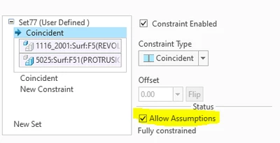

I am facing an issue while assembling multiple sub assemblies.After gave a constrain to one sub assembly to another one. when i came out from edit definition assembly will goes to fixed position but we have one more degree of freedom. If i gave mate with any other, the sub assembly is not moving with respect to that one.

Another thing to check is that the "Allow assumptions" box is not checked. This could cause the part to be totally constrained when you have not constrained all degrees of freedom. Here I have a cylindrical constraint and a planer constraint, but it doesn't matter if the part rotates within the cylinder.
