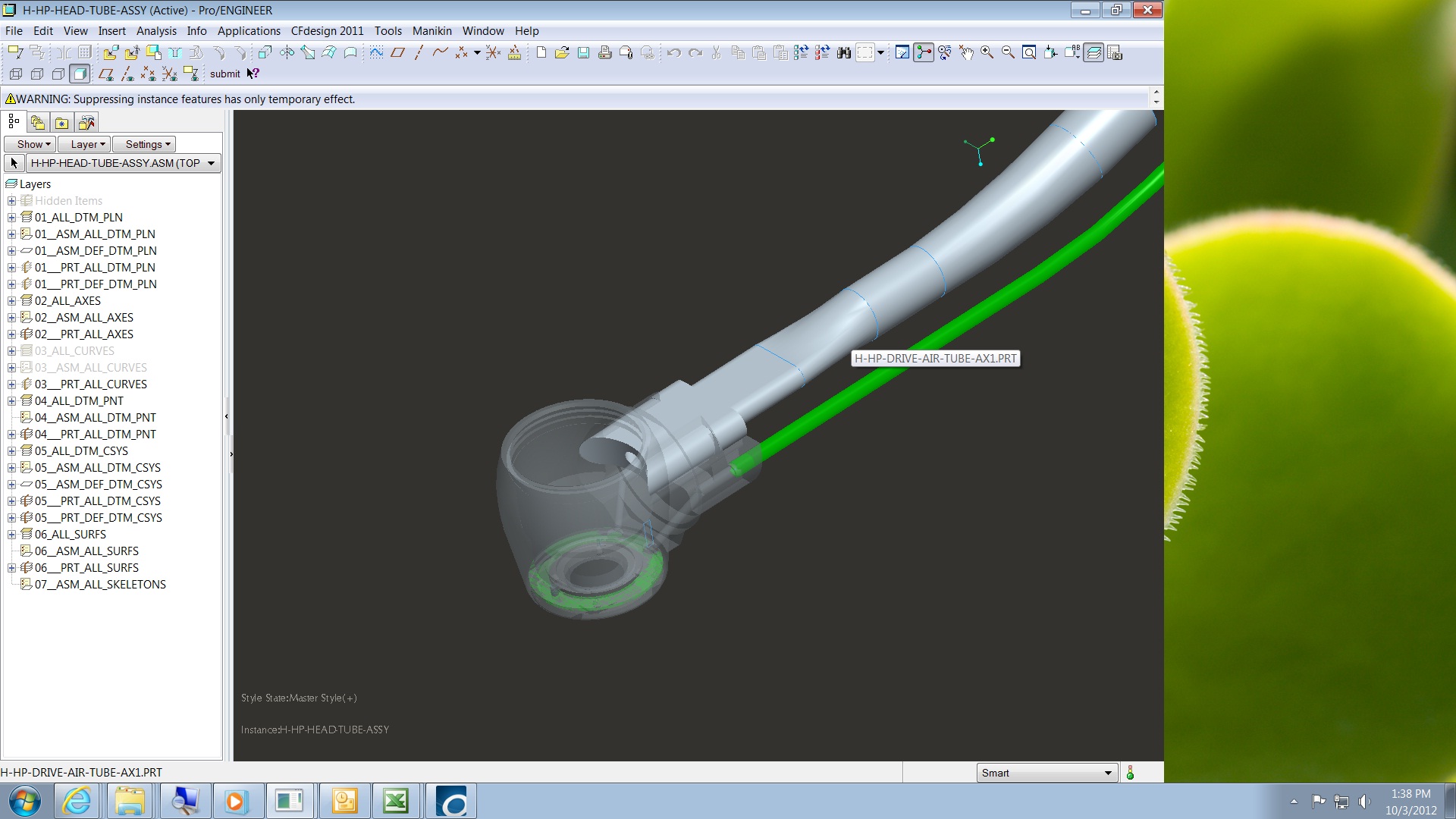

Hello
I'm using Pro-E Wildfire 4.
I'm trying ot make drawings of an assembly process. To do this I'm trying to make drawings of models which are a mix of Transparent and regular parts. (The regular components indicate the latest step in the assembly.) I can't seem to get the drawing views to appear on my drawing as it is in my model. (Transparent parts no longer have their transparency.).
Does anyone know of a way to show a drawing view that has a solid drawing view style and that will show transparent parts?
