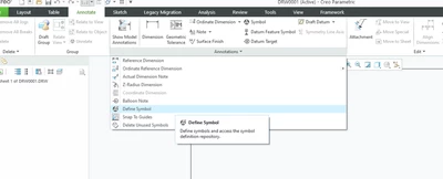

I just installed CREO 10.0,  I was 6.0 before.  I can't figure out how to edit a drawing symbol in 10.

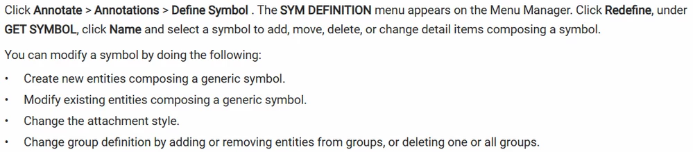

tbraxtonAnswer
Jun 15, 2023 2:28 PM UTC
tbraxton
tbraxton22-Sapphire IIAnswer
HBreton10-MarbleAuthor
Jun 15, 2023 2:31 PM UTC
Thanks!  I couldn't see the annotations drop down.

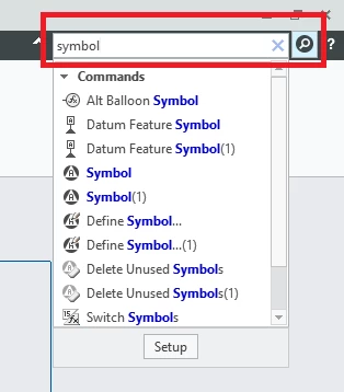

Jun 16, 2023 7:44 AM UTC
you can use Search tool to find some command.
