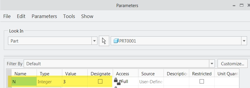

One more question related - I saw that d12 (the dimension of point spacing on pattern) is d12=LENGTH:FID_MEASURE_LENGTH_1/6 where number six is the spacings between points (number of points +1). Is there anyway to associate the number 6 with parameter of number of patterns (d12=LENGTH:FID_MEASURE_LENGTH_1/(instances of pattern +1)?
Thanks.
tbraxton
May 1, 2022
It is possible but you will have to define the number in a parameter and use that in the relations. Define a part parameter for N instances as an integer.
Then use that in the relations to control the instances and spacing values.
p14=N
d12=LENGTH:FID_MEASURE_LENGTH_1/(N+1)
