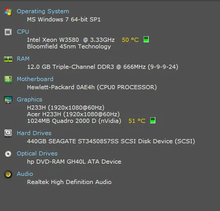

We have had an issue since going to Creo 1.0 that causes crashes across all our workstations. We work with several Creo windows open and are seeing crashes when switching between assemblies and parts. The issue always occurs the moment you click the activate window within Creo.
[cid:681021519@01032012-3449]
Still having the issue with M030, Win 7 64, Nvidia FX3800 graphics card. Just upgraded to the latest Nvida driver, did not resolve the issue.
Any suggestions?

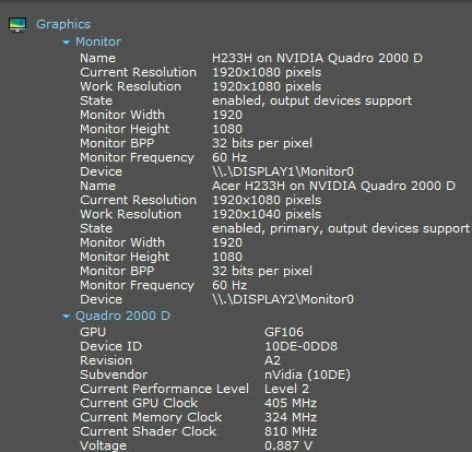

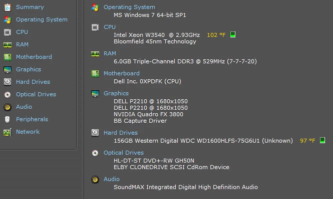

We have been runing Creo 1.0 since M010 and currently run M030. We have not seen any issues with Crashing, other than the normal occasional crash that has been around since Pro/ENGINEER 1.0
We are running the 64-bit version on Windows 7 Professional 64-bit. Our Workstations are Dell Precission T3500's. I attached the specs. we are running just in case it can help.

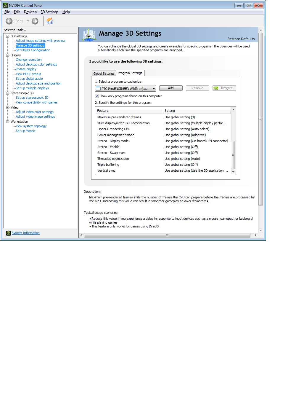

I had the same problem (sound like it anyway). Running W7x64bit on a Dell Precision with the NVIDIA processor. I went to the NVIDIA control panel which you can get to by the computer control panel, there you can tell the graphics card to run pro/e or creo. By default it seems that the computer wants to run everying on the integrated intel graphics which seems to crash when running Creo. Oddly enough, that did not occur with earlier (wildfire) releases, just Creo.
March 5, 2012
Thanks Scott,
It seems that this is already OK, at least in the NVIDIA Control panel under Manage 3D settings it does recognize parametric.exe as an installed application and has the "program setting". Is this the setting you are referring to? I have attached a screen shot to show the settings. Are there some specific settings I need to change?
Bill
March 6, 2012
If you have the option for Pro/ENGINEER on your Nvidia 3D Settings, you should only need to select it with no further changes. The interesting thing is that this option is only found on Certified versions of the Nvidia cards. We run a higher end card but it's not officially certified by PTC and you won't find the Pro/E or Creo settings anywhere but the card runs Creo great with all Windows 7 Aero options enabled.
I guess just because it's not certified, it does not mean it won't run Creo great. We are running NVidia Quadro FX 3800 cards which are not certified by PTC but work great.

That's the interface - there is a selection for PTC Creo 1.0your screen shot shows PTC Pro/E.... also, try this...if you have a desktop icon for creo, RIGHT click the icon and look for the pop up menu selection:Run with graphics processor (arrow) <choose &quot;high-performance=" nvidia=" processor=" (default)&quot;="> mine says (default) because it is set up already that way.
