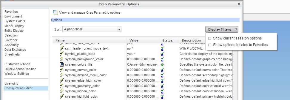

Hello
I could use some help. I am evaluating Creo 1.0, M020 Datecode. We currently use a global config.pro combined with a local (user) config.pro. While in the configuration editor, is there a way to just view the local config.pro and export just the local if changes are made? Previous versions let you pick the file displayed by local or global with a file path.
thanks
BL

Hi Brett,
If I understand correctly try unchecking the 'show current session option' in the 'display filter' (see attached)

Hi Marc,
I tried turning off the "show current session" in the display filter. The problem is when I export the config.pro, I get the the combined options of the global config.pro, default.pro (sup) and and my local config.pro. It doesn't see to distinguish between local, load point and system default when you export--it combines them all into 1. Previous versions did not have this issue and could easily toggle between the different files and save. I can work around it by exporting to a different directory and editing the config.pro with notepad to carve out the non-local options.
I don't know if this is an oversight or there is a specific reason this is occurring.
thanks
Brett

Hi Brett,
When launching Creo I already have customer specific config files loaded in the working directory. I normaly save working directory config files (if changes are needed) with the 'show current session' ticked. I save the changes to the working directory, and when doing so I see no changes occurr to the config files in global load point.
Where are your local config files loaded?
Marc

Open a call with PTC and have them add your call to SPR 2095853. Ability to view and save options loaded from different configuration files is lost in Creo Parametric 1.0.
