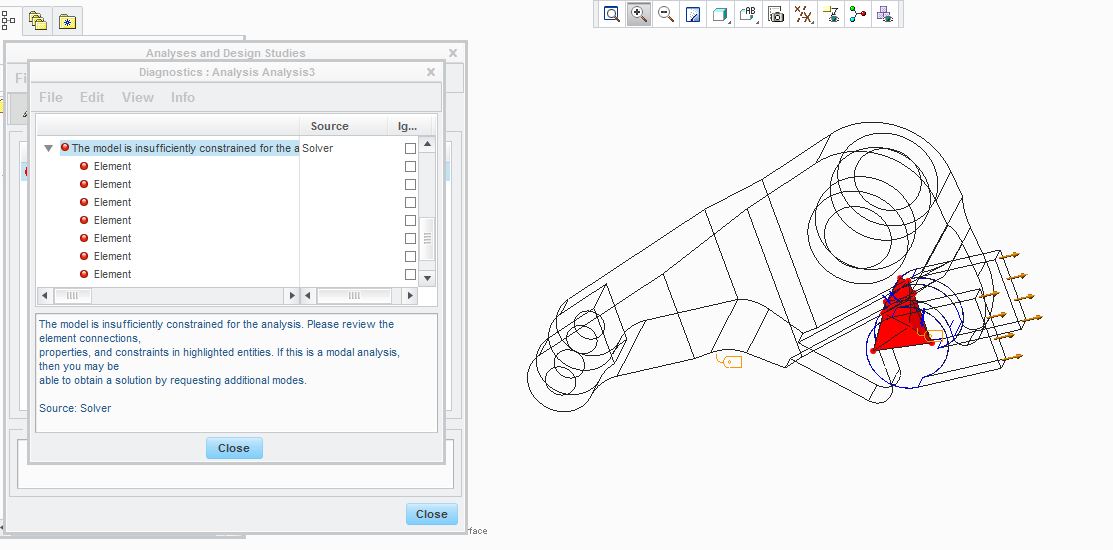

Hi, I am trying to run a simple stress analysis on an assembly using a static analysis, but I keep getting the error:
"The model is insufficiently constrained for the analysis. Please review the element connections,
properties, and constraints in highlighted entities. If this is a modal analysis, then you may be
able to obtain a solution by requesting additional modes."

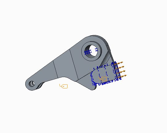

Total Assembly:

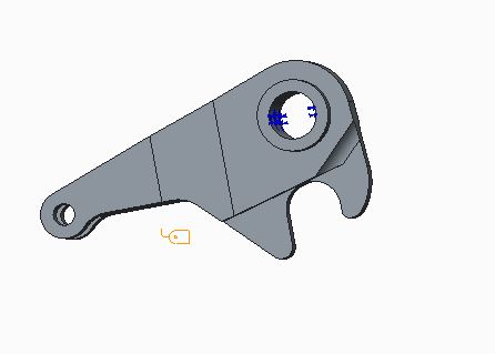

Latch:
Pin
Error
I have defined:
-materials
-surface-surface contacts
-hole constraint in all directions on latch
-surface constrait on all pin surfaces in all directions, except X (same direction as load)
I tried doing the same analysis on a single part (rather than an assembly) and it works fine.
Does anybody have any ideas how to resolve this issue?
Thanks a lot
Mark M.

Mark,
Is the latch fixed so that it can't move using a displacement constraint?
I'm assuming the pin has some freedom to move. The pin is fixed in what directions using a displacement
constraint?
Don Anderson
danderson1-VisitorAnswer
April 25, 2012
Mark,
Make sure the material files have Denisity, Young's Modulas, and Possions assigned in them.
Don
April 25, 2012
and Yes, both parts were assigned steel from the material library and they have those 3 properties.
