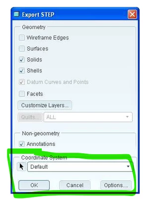

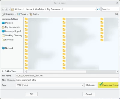

Choose the customize export option when exporting the STEP file. This will invoke another window that has the selection of the csys used for export.
