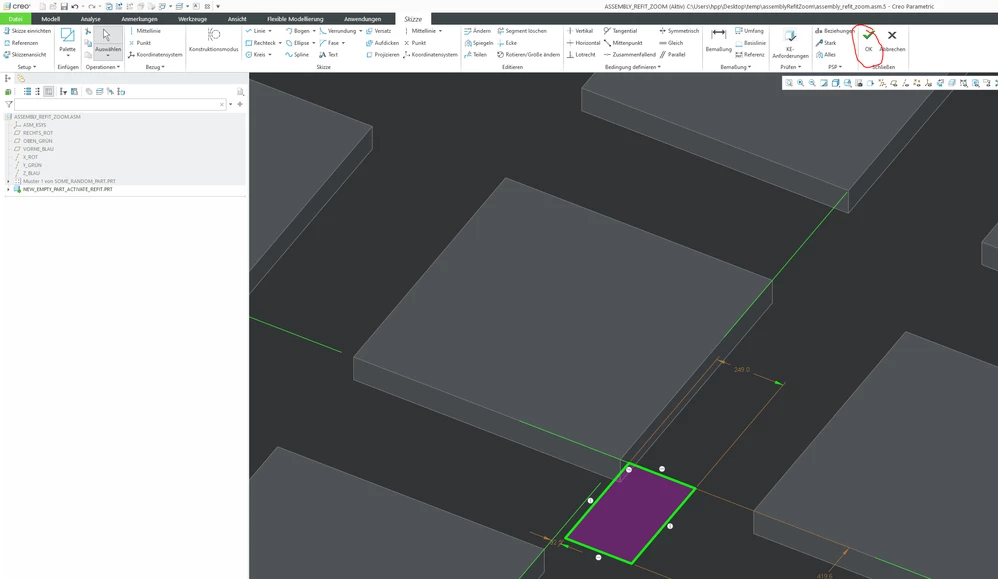

I am working on a large .asm > create new empty part > activate this .prt in .asm > create a first feature (sketch, extrude, anything) > click on OK in the sketch > and creo zooms out (the larger the .asm is, the further creo zooms away).
This behaviour occurs ONLY for the first feature in a new activated part. Once the .prt has any feature, creo does't do a "auto refit" when exiting the next feature sketch with Ok.
Did anyone ever encounter that problem? I asked my reseller (and PTC), but nobody can replicate this type of behaviour. I tested it here in the company I am working and it is the same problem on every CAD workstation. I started Creo vanilla, without any setting and still the beviour occurs.

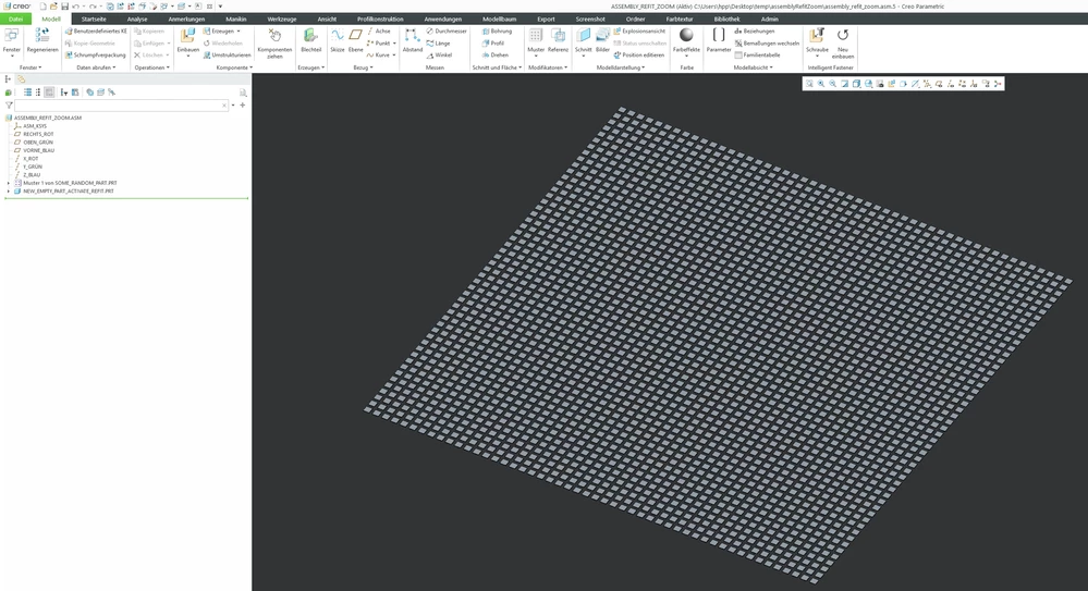

Here are some screens. I created a large .asm (75m x 75m) by pattern a random testpart:
Active a new empty part and create a sketch:

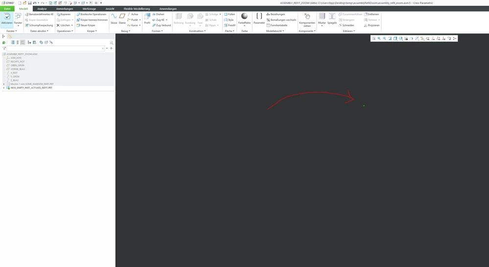

As soon as I hit "OK" in the first sketch, Creo zooms out. So far, I can't even see the .asm on my screen anymore:

Just to close this topic, here is my workaround: I added a sketch to my startparts with a single point. Put that sketch on a hidden layer. This empty sketch in the startpart is preventing the "jump-zoom" when creating new parts in assemblies.
I still hope, that PTC fixes this bug in future releases.
