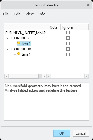

I've checked every setting I can find which was suggested to check/change.  My cord dimension is defaulted to Zero.  I get several Error messages.
When trying to save as stl, this shows...Unable to triangulate part.
I've run the geometry check, there are a couple of caution messages..."Non manifold geometry may have been created
Analyze hilited edges and redefine the feature".   I have no idea what this means, nor how to fix it.

When you get the unable to triangulate error, is Creo showing in the graphics window the area(s) which are the source of the error? It would typically highlight the problem areas in a different color.
If Creo is not able to triangulate the model, then you will not get an STL output. This is typically due to bad geometry in the model. You must resolve this in Creo if you intend to export the model geometry using STL format. Without more details it is difficult to make suggestions.
"Non manifold geometry may have been created; Analyze hilited edges and redefine the feature"
This error is typically a result of the surfaces of the geometry not being closed (gaps or holes in the envelope) which will prevent triangulation from working. The hilited edges should be visible in the graphics window.

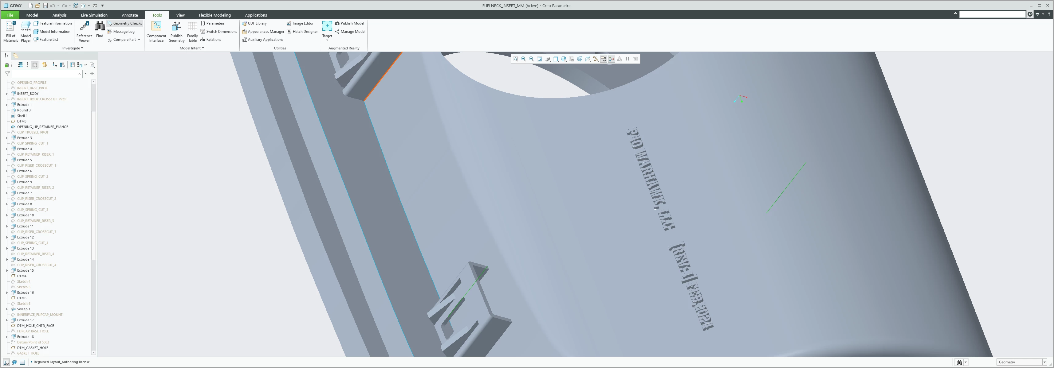

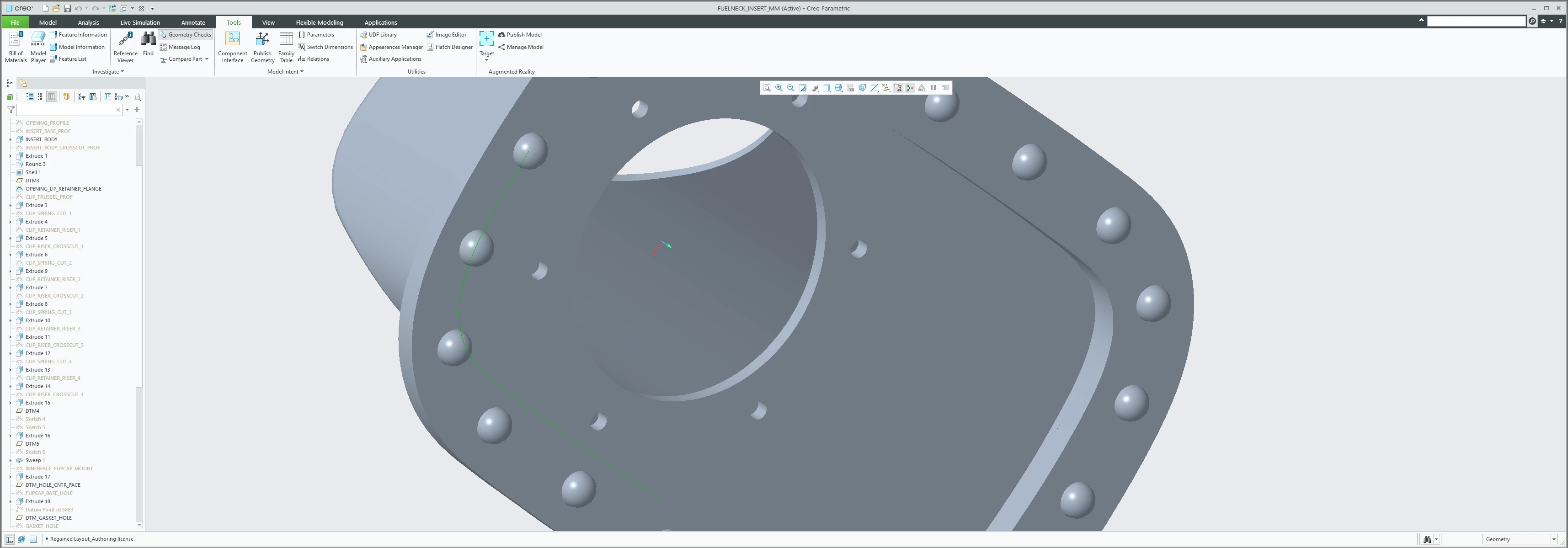

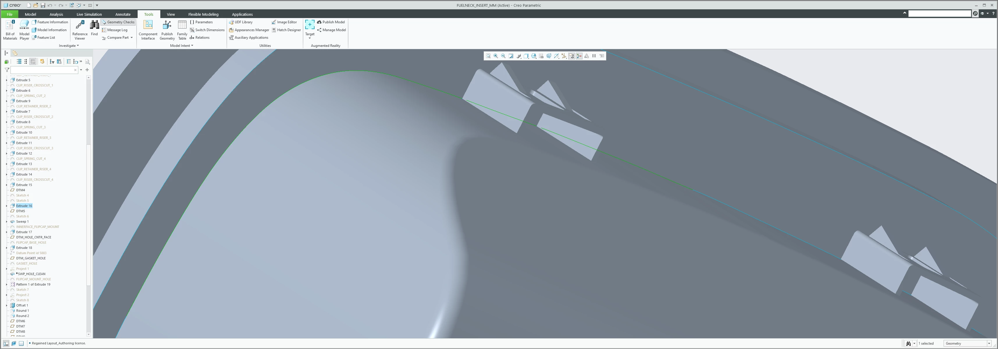

Feb 28, 2024 10:53 PM UTC
I'm not sure.  The model will regen without warnings.  If I run the geometry check, it points to some edges for extruded profile, and a sketch I used a spline to trace a profile to extrude a depth.  I tried to snapshot what it is showing.  What else can I provide to aid?

Feb 28, 2024 11:02 PM UTC
In general, having geom checks in the model is not a good thing, even if the model regenerates.
I do not have Creo 10 installed yet. Suppress the extruded text (P40 Warhawk....) I see in the model and then save the model in a neutral format. Try saving the model as STEP using the AP214_is protocol and export the solid if it is a solid model in Creo. Also try exporting it as a Creo neutral file. When you zip these the file size should be within the upload limits here. I can open either of those formats in Creo 9.
