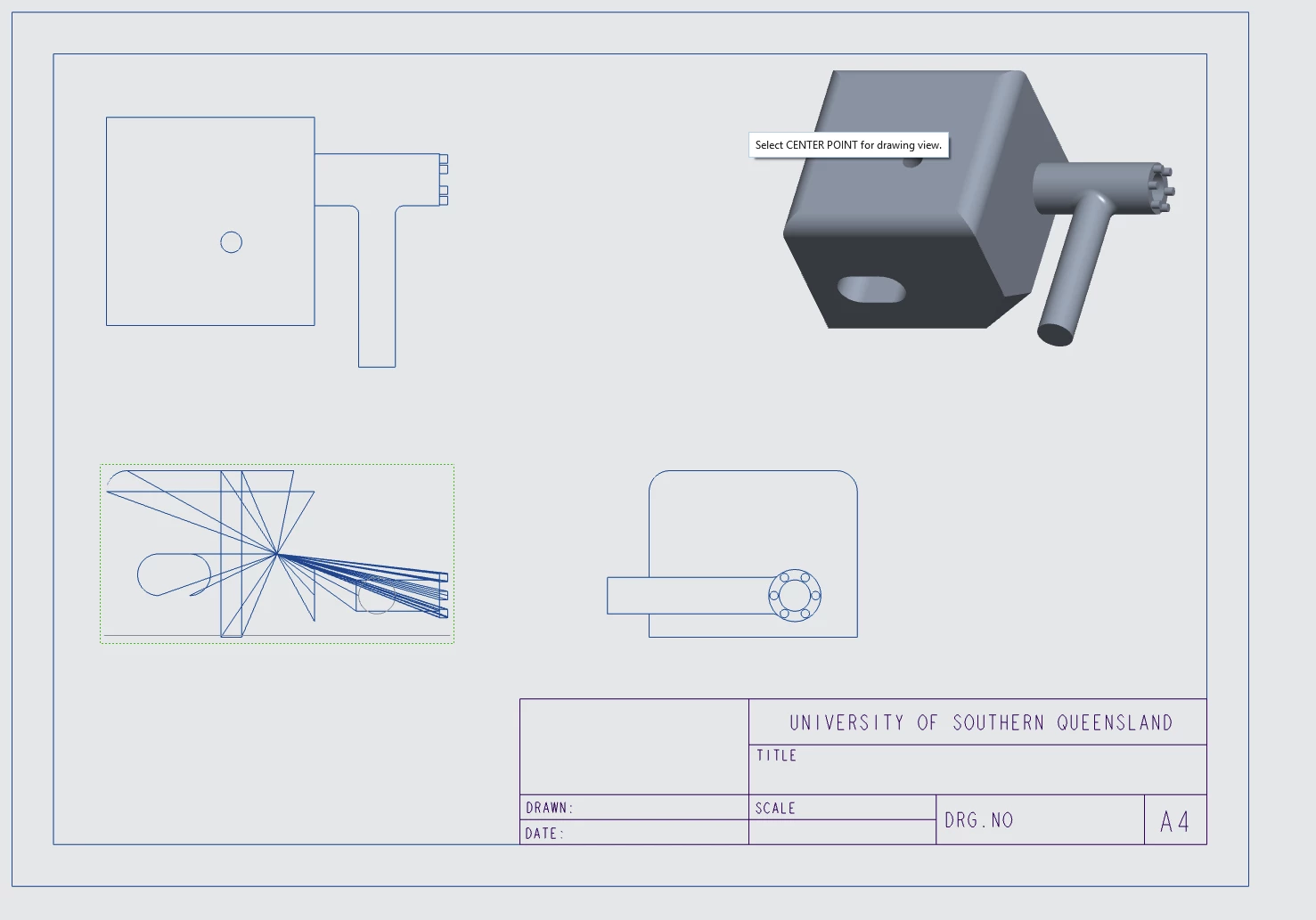

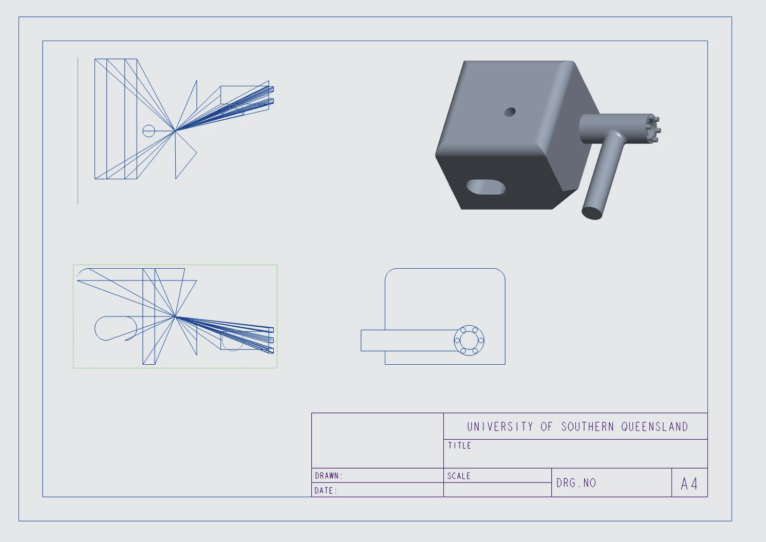

Issue 1 – Hidden Line Views in Drawings
When I create a drawing, all views display correctly in No Hidden or Shaded mode.
However, as soon as I change any drawing view to Hidden Line, the hidden lines are completely incorrect. Instead of showing normal hidden geometry, they all radiate from a single point, producing a starburst effect.
This happens with:
  • Top view
  • Front view
  • Side view
  • Projected views
  • General views
So it doesn't seem to be related to a particular drawing view or orientation.

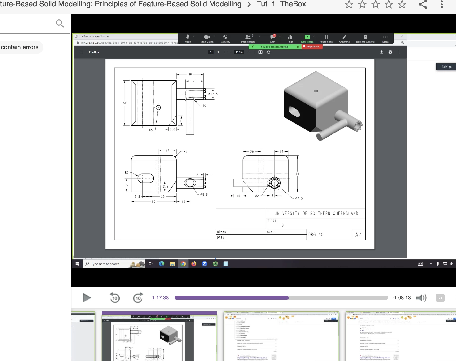

I've attached screenshots comparing my result with the expected result from the course lecturer.

18-Opal
Jun 30, 2026 11:25 AM UTC
That is a graphic card driver bridge issue between Parallels and the Mac…   I saw this on Mac Intel … you confirmed the same issue on Apple Silicon.
You might try an earlier version of Parallels (downgrade Parallels) - this issue showed up about 4 months ago in a Parallels update.  Worked fine before that.
The workaround - force Creo to run with a startup flag to force graphics driver to -g:win32_gdi as a command line startup option for Creo Parametric - BUT - It will be very (very) slow.  Not sure if the Drawings will get fixed -but the models will look better.
Hope this helps.
Dave
DylanBurow
Jul 8, 2026 2:08 PM UTC
I would double check the values of these config options in Creo’s conifg.pro file if you aren't using a personal config.pro already
use_gpu_line_style_rendering (should be set to NO by default but test with it set to YES for different results)
drawing_aa (set to NO for mac or unsupported graphics)
enable_fsaa (set to OFF for mac or unsupported graphics) Default is 16X
display_silhouette_edges (set to NO for mac or unsupported graphics)
fasthlr (should be set to NO by default but test with it set to YES for different results)
