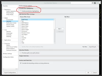

Ok, I may have found something that is causing this issue for so many of us,
I found that if i turn off this "enable preselection highlighting" in the options. (under file/options/selection). I don't have the selection issues when detailing a drawing. Its fast and snappy like previous versions of Creo when adding dimensions,
I don't have to click 3 times to get an edge selected when adding a dimensioning to a drawing.
HOWEVER......It does however suck not having the edge pre highlighted though.
It also REALLY sucks when in the 3d model not having it highlight.
So i don't think this is viable option to always keep the pre highlighting turned off.
But I DO think this is something PTC should be looking at as it maybe the culprit of the selection issues in Creo 11.
Jun 5, 2025 2:50 PM UTC
Unfortunately preselection highlighting is a key part of how the Creo UI works.  It may help as a workaround in some cases, but I would not say that it is the "cause".  That said, I do have a mapkey (F1) to toggle preselection highlighting for cases when it helps to disable it momentarily.
The root cause of this delayed selection, as others have suggested above, is that compatibility with graphics hardware and/or drivers on "older" machines may not be supported by newer versions of Creo as they come out.  Every time you deviate from the line of graphics hardware that is fully tested and certifiably supported by PTC for that particular version you run the risk of experiencing these types of graphics glitches.  The delayed clicking on V11 (which doesn't happen on V10) appears to be an example of that.  I've run into this kind of thing quite often over the years.  Even variants of graphics adapters that are almost identical to others which seem to work perfectly can have some weird glitches.  Some graphics issues are barely noticeable, some are nuisances, and some are show stoppers, but invariably these performance issues come back to the graphics hardware or driver not actually being supported.  The best bet for the user is to ensure that the hardware platform and graphics adapter has been fully tested and is certifiably supported by PTC.
