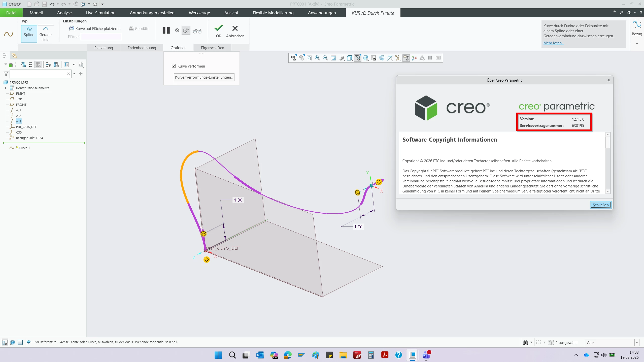

Hello Creo 12 users,
I’ve recently been having a problem with creating curves.
When I go to Options for the curves and adjust the points, the curve jumps back to a different shape after I click OK.  It looks as though the points aren’t being saved.
I’ve attached a video.
Does anyone recognise this problem and have a solution?
Thanks and best regards,
Ramon Bohne
(Siemens Energy)

Ramon_Bohne
Hello Community,
Just a quick update.
At first, we updated Creo last month from Creo 8 to Creo 12.
I’ve discovered that the problem only occurs with curves created in Creo 12.
If I open an old Creo 8 model and redefine a curve, there are no issues. However, if I create a new curve in the old Creo 8 model using Creo 12, the problem arises.
The same applies to Creo 8 models that I’ve saved under a new name. Redefining (Creo 8) curves works fine, but creating new (Creo 12) curves causes problems.
Best regards
Ramon Bohne
(Siemens Energy)

We had a very similar (probably the same issue) with Creo Parametric 12. The user ended up creating the curve with some other methods. I never did open a case but should have.

Hello all,
the PTC support confirmed the issue and forwarded it to R&D for further investigation.

Hello Rany,
It seems that the problem has not yet been resolved in Creo version 12.4.5.0.
If I create a curve and do not add any endconditions, no problems occur.
However, if I add the ‘Tangential’ endconditions and select one axis at a time, the curve becomes unstable and changes shape every time I click ‘OK’.
The issue may have been resolved in version 13.4.1.0, but I do not currently have access to that version.
Please have a look at the video.
Best regards
Ramon Bohne
(Siemens Energy)

Hi all,
I got the following message from the support team:
“I am pleased to inform you that R&D has resolved this issue, and the fix is planned for inclusion in the following releases:
  • Creo Parametric 12.4.6.0
  • Creo Parametric 13.4.3.0
Creo Parametric 12.4.6.0 is currently expected to be available around November”
So it seems that they finaly fixed the bug.
