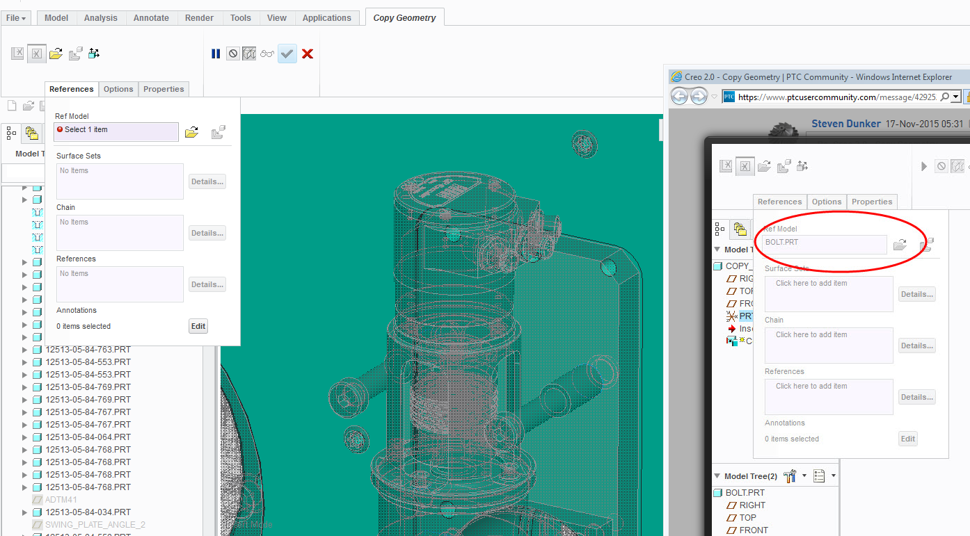

Creo 2.0 - Copy Geometry. I have activated a part in an assembly. I wish to copy a bolt in that assembly using copy geom so that I can locate its exact position so I can put a hole in the activated part, and later remove all references and hence any associativity...I have AAX but I am clueless as to how to do it like I used to in Wildfire as it isn't remotely similar!...any tips please?

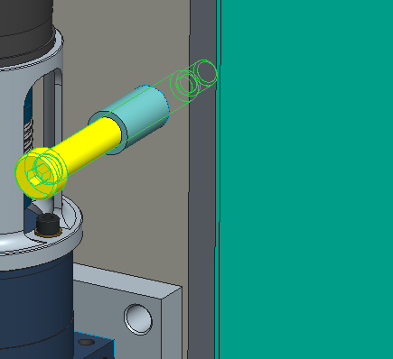

Yes Steven, I'm trying to locate a new hole so that later i can assemble the bolt into it, knowng it is in the exact place i want it to be.
The green bit is a plate...i want to accurately locate a hole to tap that is in the exact place the yellow bolt is.
In wildfire I would have activated the the green plate and simply created a copy geom of the yellow bolt surface and then go into the plate part, draw the hole and then tap it or whatever, but the point is i was able to use edge, which i can't do now. Even if i activate the plate within the assembly it still won't let me use edge or select any surface or edge to create a sketch from....for me, the functionality has been utterly ruined.

I can get as far as the image you posted Steven, but I can't select anything......

Have not used Copy Geometry before but was able to follow Doug's instructions and get geometry copied over to the part:
  • You'll find the copy geom feature in the "Get Data" area of the model tab.  Activate the part in the assy and select Copy Geom.  By default, it looks for a "Publish Geom" feature, which is a predefined set of geometry in the source part that you want to share.  Unclick the publish geometry button (a box with 3 arrows) and then you can pick specific geometry items to be copied into your part.
Your screen shot looks like you selected the wrong button.  Select the last button to turn it off.
