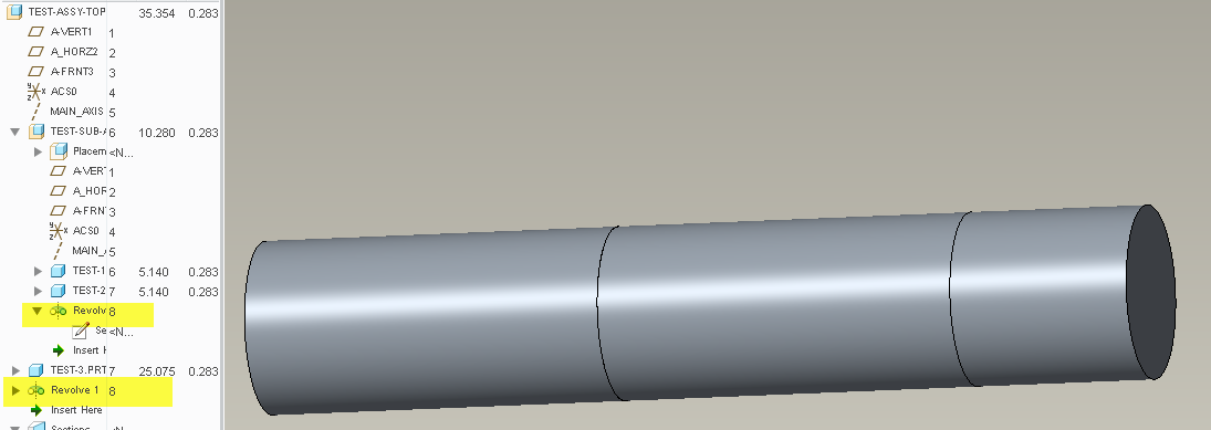

Below is an image of my test model, with 2 levels of revolved assembly cuts.

Hello Stephen and Christopher.
Thank you for your reply and your time.
I have enclosed a video showing the problem, together with a snagit of the structure tree.
Please ignore the calculator as it is placed for the obvious reason of IP.
Video Link : 7340
