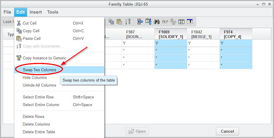

I am currently tasked with making updates to some models/drawings utilizing "Family Tables". Old drawings made in much older PTC versions.
Would be beneficial to move columns around to keep model development together... How would you do this?
I have tried Excel and everything that I know of and... nothing.
Any suggestions on how to move (shift) columns?
October 22, 2014
Have you tried "Swap columns"?
rreiff1-VisitorAuthor
October 22, 2014
Jose,
That is a helpful answer; however, I have 40 columns in this Family Table.
Why can't we move columns around in Excel? or Insert Columns where we can?
