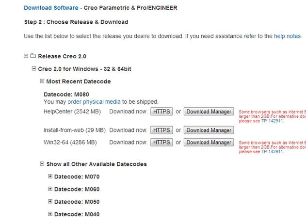

OK - I am not digging up something that is REALLY old - just sorta' old.
I am looking at the PTC software download site and trying to determine which
build I should get for my initial install. I see in this thread that there
is considerable mention that M090 is pretty stable and that is the latest
build - I am all for that, but the latest (current) build on the PTC site
M080.
What's up with that? Did they retract M090? Am I missing something?
Thanks - Nate
December 5, 2013
M090 Will not be released until Dec 20th.
Use m070.
David Haigh
