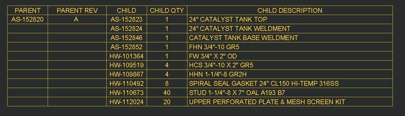

I'm trying to make a customized BOM table that will play nice with external software when exported as CSVs.
The columns I need are as follows: Parent, Parent Revision, Child, Child quantity, Child Description
The last three are easy, typical repeat region setup for BOM. The parent columns are the problem. I can grab the parameters from the assembly, but they do not repeat in the table because there is nothing to repeat. I need the same parameter pulled in for every row on these columns. Is there a way to make the same "value" repeat with the rest of the table? See attached.
