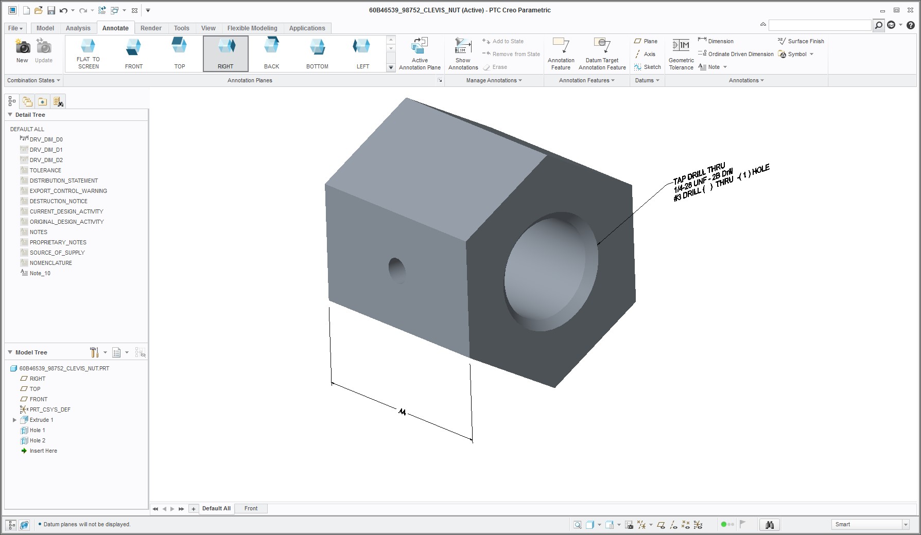

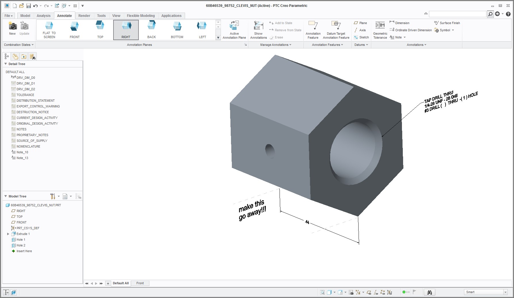

When I move a shown dimension to a new plane in a 3D model (not a drawing) it creates little dashed offset lines. I have tried picking the lines, moving the lines to a new layer then turning off that layer. So far, I can't do anything to make these lines go away! Please HELP!!

Set config option display_z_extension_lines as no to control the display.
