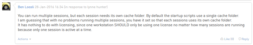

There is a product idea to bring back that functionality. Multiple session of Creo3 embedded with Windchill
February 15, 2017
Especially I like following reply. I hope that the procedure mentioned in it works well.
