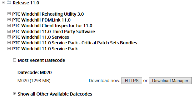

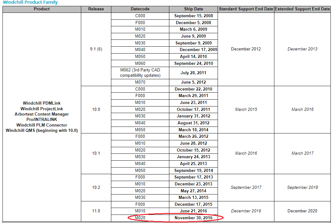

We are currently running Intralink 10.0 with creo 2.0. A while back we looked at upgrading to intralink 10.2 to utilize creo 3.0 (currently just using to convert solidworks files to step). Looking at the compatibility matrices, it appears that when creo 4.0 launches, windchill requires at least 2 more date codes to be functional with 4.0 (currently shows F000 as latest). We have no in house support, so all upgrades will be performed by one of PTC's authorized service providers. It's a pricey upgrade and don't want to upgrade before we can use creo 4.0 with intralink. Does PTC plan on releasing windchill upgrades on the 4.0 release or am I missing something?
http://support.ptc.com/WCMS/files/67180/en/CreoWindchillCompatiblityRoadmap_11292016.pdf

11.0 M020 is already out.
I see the download as a service pack.
Aaronm8714-AlexandriteAuthor

I see that now, but the compatibility matrix seems to lump intralink and windchill into the same category. Does that mean I can run Creo 4.0 with the F000 datecode of intralink?

Minor but important clarification:
- Intralink is the same installation as Windchill, but with many things disabled.
- With Intralink, Oracle from PTC is included in the installer; with Windchill you're on your own for the database (either Oracle or SQL Server).
- There is no actual "Intralink module."  Intralink is essentially Windchill PDMLink, with many things disabled.
- Compatibility with CAD releases is identical for Intralink and Windchill.
