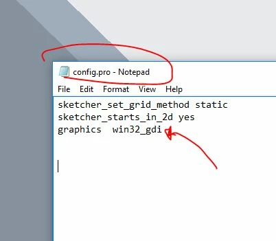

the problem can be caused by graphic card drivers. To verify it, please open config.pro file located in text subdirectory if Creo installation and add following option in it.
graphics  win32_gdi
Then start Creo and test its behaviour.

Hello Martin,
thanks for the reply, but it doesn't do anything...

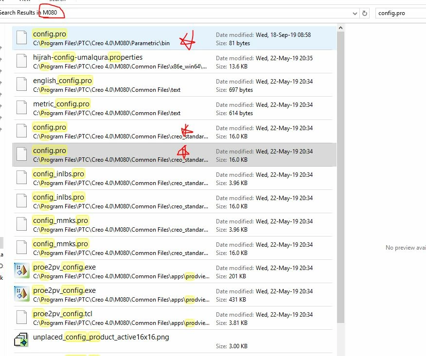

but actually, there are 3 config.pro...I only added the command to the one in side Parametric\bin

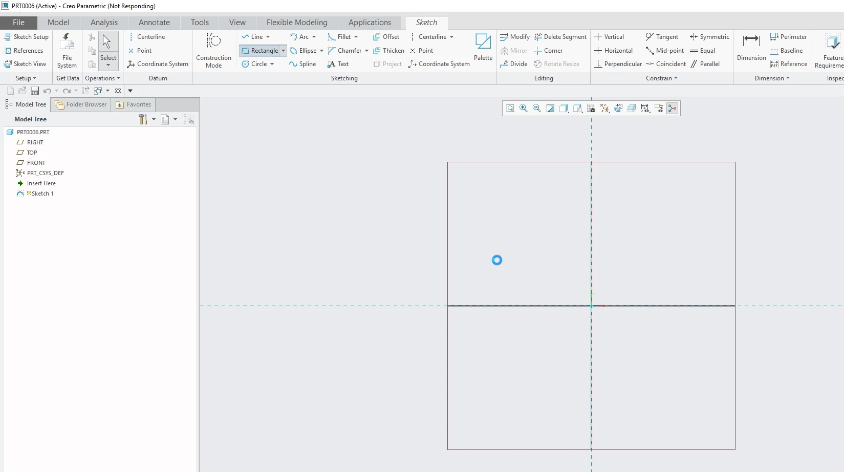

and you see capture3.jpg, that all I click was a rectangle without anything open in the back...still spin for like 15sec before i can start drawing my rectangle

you have to modify config.pro file located in text subdirectory in Creo installation.
Example:
On my PC Creo 4.0 is installed in E:\PTC\Creo4_M100 directory
and config.pro is located in E:\PTC\Creo4_M100\Creo 4.0\M100\Common Files\text directory.
