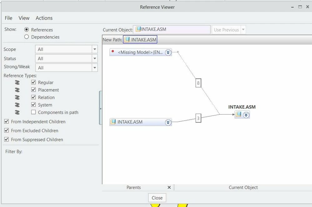

I haven't used the Reference Viewer for some time but I am trying to track down a circular reference. I have watched several videos that go through the process and all have a "Paths" tab in the Reference Viewer which I do not have. Did something change in Creo 4.0 or earlier that got rid of the Paths tab?

I have to revive this thread, beacause I have exactly the same problem.
In almost every video I see there is a "Path"-Tab inside the reference-viewer, but it doesn't exist in my Creo.
Is there a config-pro-option to activate it ? Or how can it be displayed ?

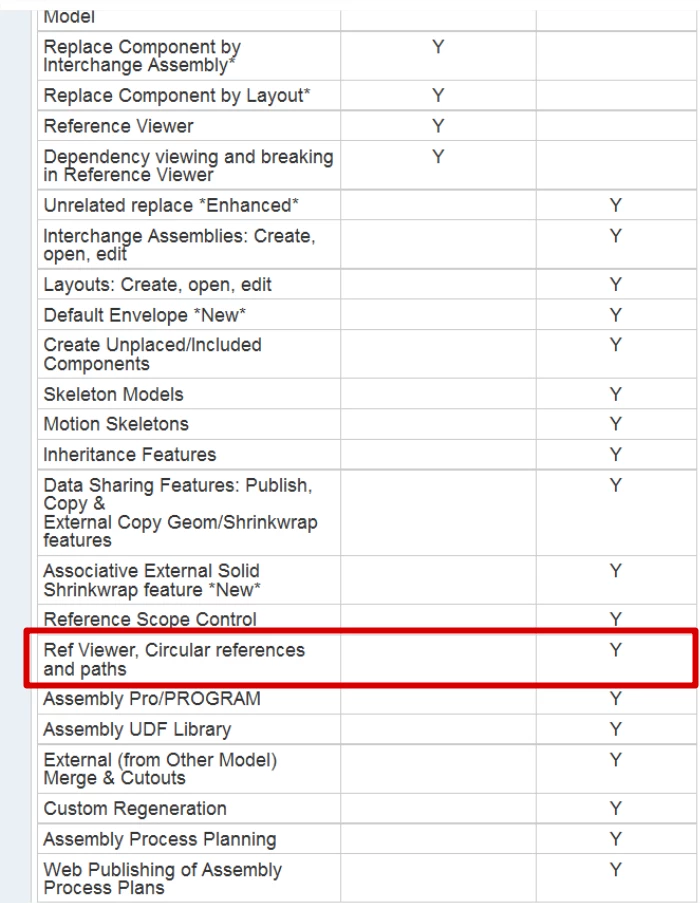

The Paths Tab is only available with AAX (Advanced Assembly Extension):
