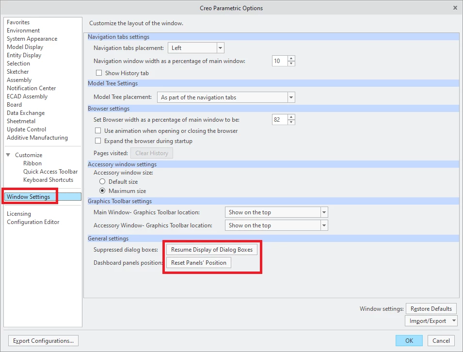

@gkarthikyn wrote:
When i click the dimension text , that pop up dialogue box is not appearing. i used to get that before but yesterday pop up dialogue box it not coming up. in Right click i am not getting properties in the menu that appears after right click. Not sure why suddenly it disappeared?
try resetting UI.
File > Options

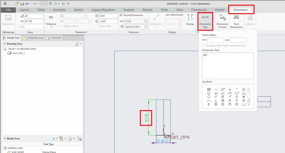

KenFarley
Dec 28, 2020 6:02 PM UTC
Creo 4 has a different interface than what you are apparently used to. To edit a dimension text and all that stuff you select the dimension of interest and then one of the ribbon entities will be "Dimension Text" (four in from the right). Click on that and dialog box will appear that lets you edit the text.
Is it better? I don't know. Different, I suppose.

in Creo Parametric 4.0 you should see this ...
