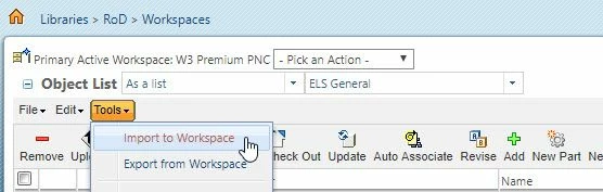

Instead of opening an assembly from your local drive use Tools - Import to Workspace
The import dialogue sequence gives you the option to Reuse models from Common Space in Windchill.
