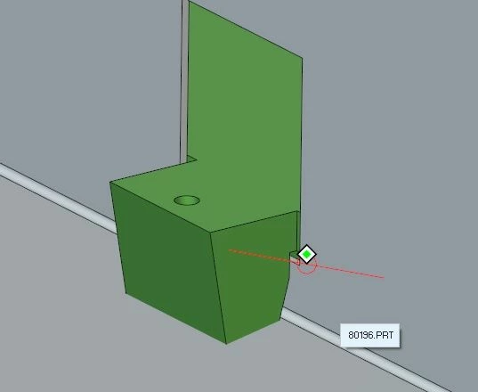

This is a known issue to PTC as I reported it a while ago. Apparently they fixed an SPR in M140 that changed the auto rotation algorthim when using a 3Dconnexion mouse. The orientation centre being visible all the time is being sorted for the next datecode so I'm told.
You should notice that the behaviour of your 3d mouse is different than it was if you turn off your spin centre. It kind of re-centres itself when you zoom in then release then start spinning again. It's pretty good when you get used to it. However, it appears to have gone back to the old way in Creo 4.0 M020  which is another issue!

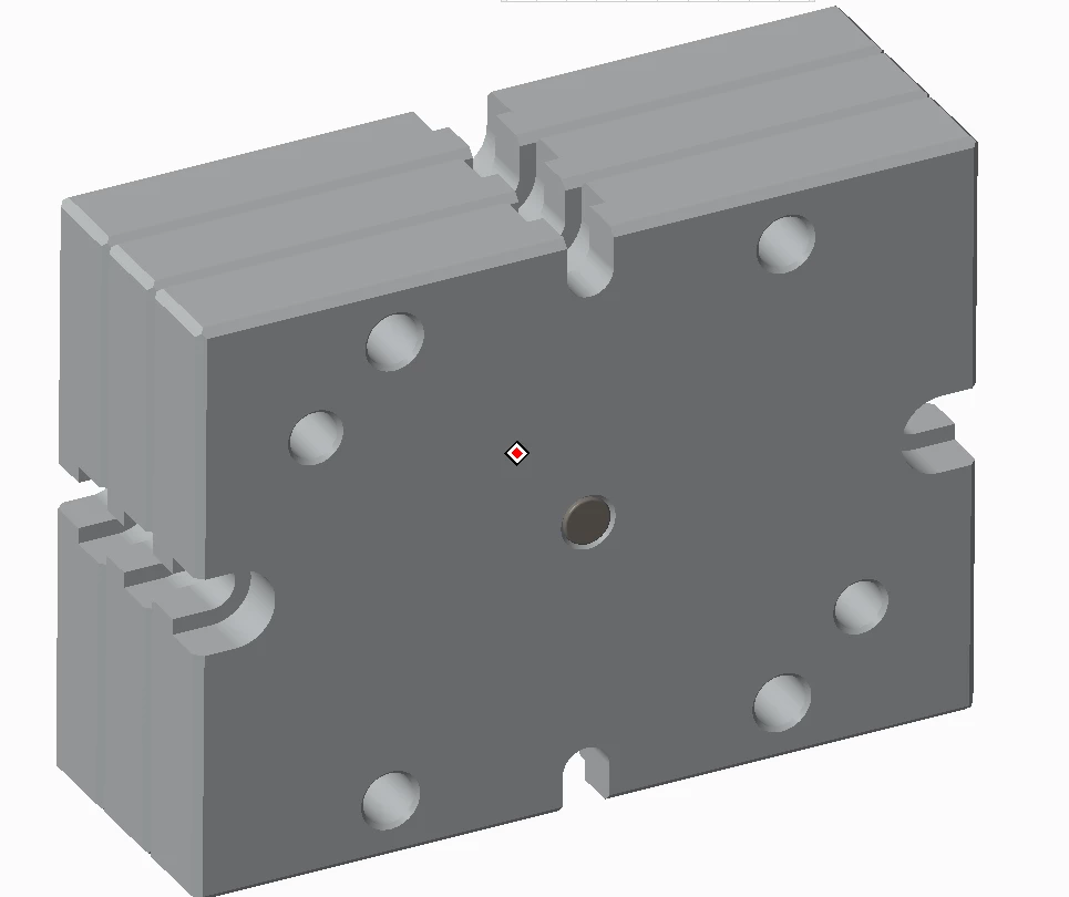

What Creo application and version are you using?  I'm using Creo parametric 2.0 with a Space Navigator and see the opposite.  Using the Navigator I see nothing, spinning with the middle mouse button I get this:
I've done nothing special in either the Navigator or Creo config files that I'm aware of.

I'm using Creo 3.0, M140. I should mention that I did not have this problem on M120 and it only appeared when I upgraded to M140.
