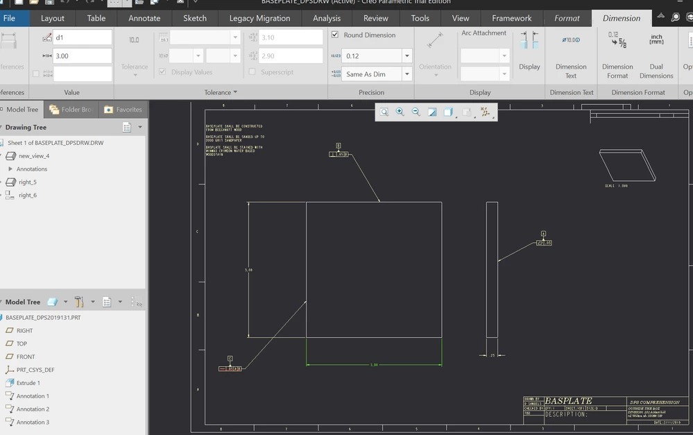

cannot change the tolerance settings on my dimensions, unknown if there is a
hidden setting switched on. the drop down menu for tolerances is also grayed outCapture15.PNG
Best answer by BenLoosli
DTL file needs Tol_Display set to yes.
This what I sent my users.
1.       With a drawing open, add the detail configuration option Tol_Display and set it to YES.
a.       File – Prepare – Drawing Properties
b.       In the new window, under Detail Options, select the Change button on the right
c.       In the Options window, there is a search function at the bottom
                                                               i.      In the option box, type TOL and the box should fill-in with tol_display
                                                             ii.      Then press Find, Select tol_display from the list
                                                           iii.      In the Set Value box, change it to YES
                                                           iv.      Press Add/Change and then Close
                                                             v.      In the option display window, press OK, then Close in the Drawing Properties window
Change any dimensions that need a different tolerance than what is specified in the Unless Otherwise Specified box.
2.       Highlight the dimension to change
3.       You can change the Tolerance type
a.       Nominal
b.       Basic
c.       Limits
d.       Plus-Minus
e.       Symetrical
4.       Tolerance values can be specified
5.       Dimension display can be changed
6.       In Dimension text, you can add modifiers to the dimension text
7.       Reference Dimensions are created separately from a hard dimension, they do not have tolerances and are not to be created using the Dimension Text option by adding brackets! If created as a Reference Dimension, you can not add a tolerance.

DPSIntell1-VisitorAuthor
February 11, 2019
Thank you, the step by step format of yours worked out great.
looking forward to being the one with the answers at some point
