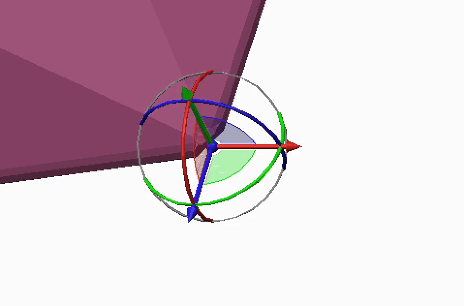

Back when I used Creo 2, in assembly mode when I added a new part I had what I call this dynamic moving option where I could drag the part where ever I want and it showed me the cage etc... (see attached photo)
I am now using Creo 5 and my assembly mode doesn't have this feature available to me.

No, this isn't want I can't figure out. Please look at the picture I attached. Then you'll understand what i mean.
Its the caged-sphere type thing I'm trying to get back. It shows up in my Creo 2 right after I add a new part to the assembly, during the phase where you are placeing it. It allows you to simply click and move by clicking one of the cage-circles or allows you to easily translate the entire part by clicking and dragging the center sphere located inside the cage.

i have ssen the screen shot...yes i am talking abt that caged-sphere type thing only...it is not there in creo 5..creo 5 is an older version...too move a component in creo 5.0 you have to use what i have told previously.
