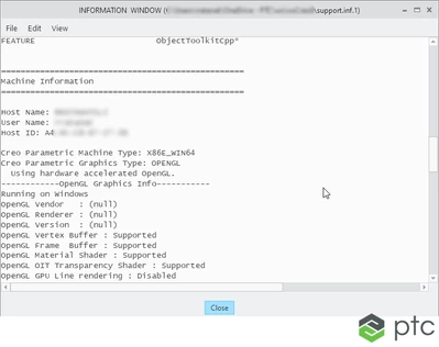

    Aug 9, 2022 6:20 AM UTC
    Your appearance gallery display darker colors than expected and the article 328931 suggests that this is caused by the option graphics set to win32_gdi.
    One way to check that is to display your display information like so:
    Can you paste your and confirm that the line Creo Parametric Graphics Type shows indeed : OPENGL?
    By elimination this will confirm the article does not apply to your situation.

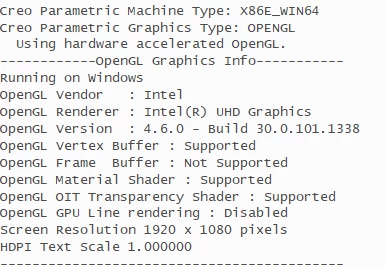

    8-Gravel
    Aug 9, 2022 4:39 PM UTC
    Graphics Type is indeed OpenGL.
    The only thing not supported is OpenGL Frame Buffer. I don't think that this should be causing the issue:
    Aug 10, 2022 6:10 AM UTC
    About the Frame Buffer, try the option  enable_opengl_fbo yes.
