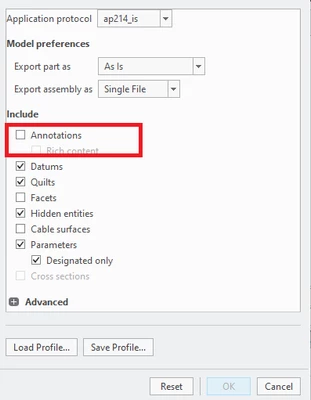

Jumping from CREO3 to CREO6, we lost the ability to export STEP with a user defined CSYS. Sure we had seen the thread of, 'CREO 4.0 STEP file export options' and check box the Customized Export. Once OK is clicked, the pop-up window does appear with the Coordinate System selection all GRAYED OUT. Thus, there is no possible way to choose a user defined CSYS from the file.
Tried looking at the FILE > DATA EXCHANGE > EXPORT PROFILES > STEP > SETUP EXPORT PROFILES and nothing was found of value to toggle or activate this option.

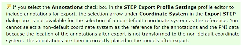

Got it.  You cannot choose a coordinate system when 'annotations' are included.  Uncheck those and then you can pick a csys.
